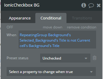

This is what I am doing:
Created the custom state:
When the checkbox value is changed and it is checked I set the state like this:WF_Bg_SS_2
And this is the condition to uncheck the other check boxes:unchcek
What am I doing wrong?

I’m wondering if the conditional won’t change the checkbox status on the fly (only on page load), so maybe you need to run a custom workflow with an action that unchecks all boxes and then another action that just checks the box you want to check?
Looking at the workflow element actions, but I just can’t find any that would change a checkbox.
