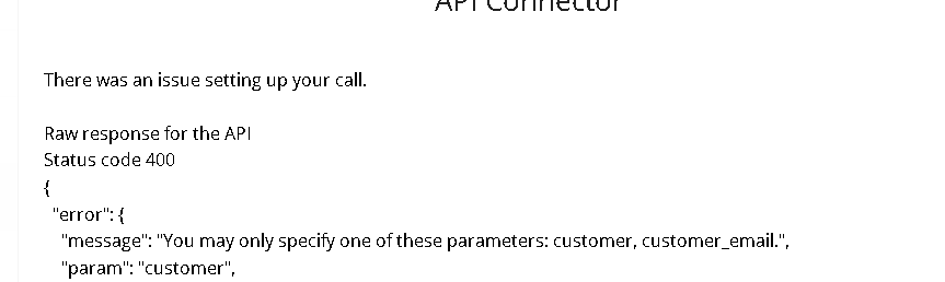

i use the parameter customer_email in the call to identify the customer in the checkout and the value of that is current users email
and when i try use both parametre im not allowed to do that

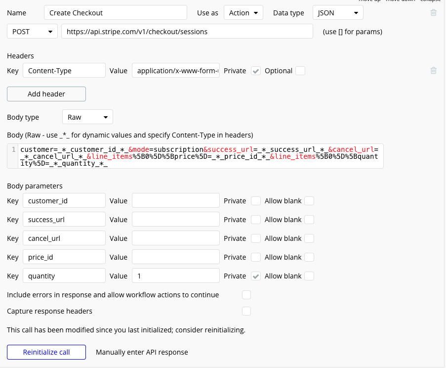

You’re creating the customer beforehand correctly, yet when creating the checkout session, it still ends up throwing these errors. Below is how the checkout session is set up in my API Connector—see if there’s anything different from yours that could be causing the issue:
Also, keep in mind that I’m passing the Authorization in the private key in the header.
I hope this helps.

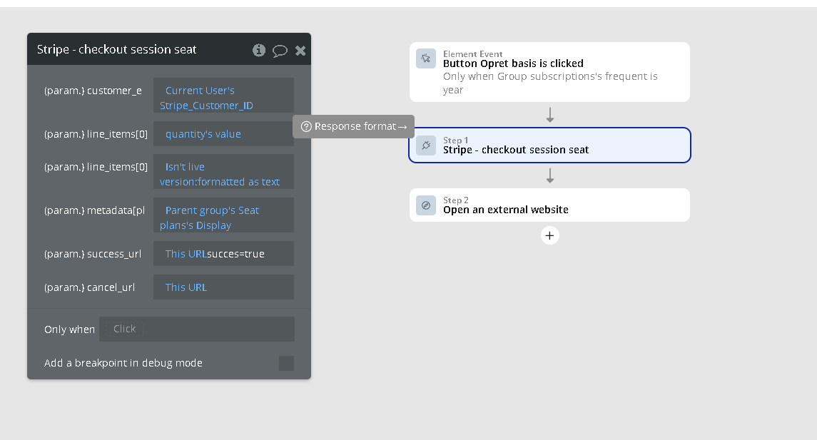

If all you have is customer ID the call will not create a new customer. If all you have is customer email the call will not recognize an existing customer.
You need both ID and Email as Optional parameters that you set with a dynamic expression based on if current’s user stripe id is empty or not, so that you have ONLY One checkout session api call that does BOTH create new and recognize existing customers.
aaaah.. that make sense..
i think i have made a setup now based on 1 API workflow of checkout session but with conditions for each action of what plan it is.. it looks like that do the thing..
