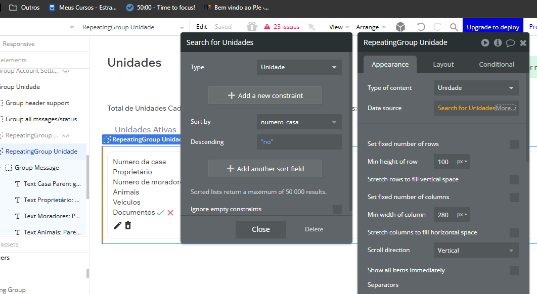

Hello everyone, I’ve already made several queries to GPT, Doc and videos on ytb but I still haven’t been able to figure out why when placing a condition on icons so that they only display if there is a file saved in the documents field of the units table. In this table I have 1 field that receives a list of documents. I have a repeater group and I want to display the icon based on that. If there are documents, display a green icon, if there are not, display red.
I created 2 conditions so that it would check in the database if documents count > 0 and document is 0 to display the red icon.
I have already examined the repeating group and it does not bring the documents, only the other fields.
Hi, @leonardobelizario88, I believe that where you are writing when in the conditional, it needs to be search for units > 0, in that line because you need to check with the database and not in the visual element.
Check the icon, in the layout tab, if the option “collapse when wide” is checked. And the option “This element is visible on page load” must be unchecked.
