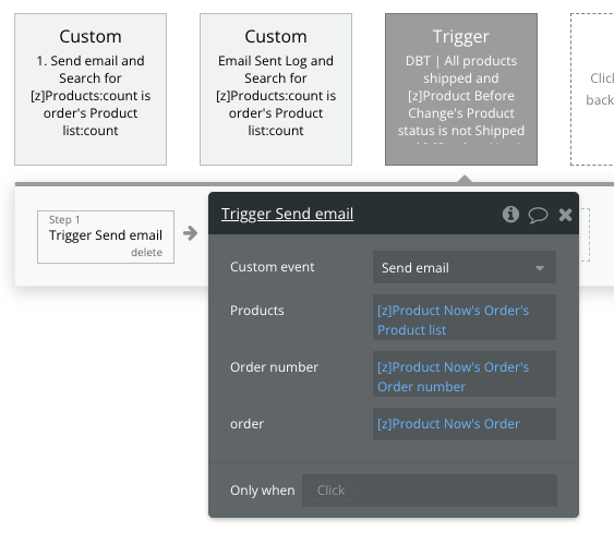

(2.a) We first set up our DBT
(2.b) Then, we set up 2 custom workflows, one to send the email, and one to log a confirmation notice within our Order datatype, for testing purposes. We will use two custom workflows here because it will force our backend to fire the confirmation log only AFTER the email expedition has been fired.
2 | a. Setting up our DBT
Here is the setup for our DBT:
This DBT is triggered when the status of a product goes from whatever it was to “shipped”. Our “ears” are therefore listening for all situations where product status switches to “shipped”, at the product data type level.

2 | b. i . ‘Only when condition’
:warning: We will go over the Products and Order number parameters later as they are a secondary subject pertaining to the dynamic contents in the email.
The objective here is to fire the email ONLY if all the products in the order bear the status “Shipped”.
This means that we are looking for ALL the products that share the same Order as the product for which our DBT has detected a status change. Because this custom workflow, as we will see later on, will be triggered by our DBT, we need to search for all products linked to the parent Order of the Product where the change was detected. For this we define the parameter “order”, of type “Order”) (see picture above in the parameter section of the 1. Send email workflow) .This “order” parameter will be defined later in our DBT.
Now under your DBT, as step 1, schedule the custom event we have just configured. As you can see, the DBT is requiring the configuration of the “order” parameter setup for the Send email event. We set this to “Product Now’s Order”.
Capture d’écran 2022-11-22 à 12.54.19
Look back at your Send email custom event to get the full picture:
In the “Search for” expression of the “Only when” condition statement, you see that the “Order = order” definition is saytin, search for products where the referenced order is, applying the DBT parameter definition, the Order referenced by the Product affected by the change.

Looking back again at our DBT’s parameters, you see that we have defined the products and the order number. This will be leveraged when we set up the contents of the email.
