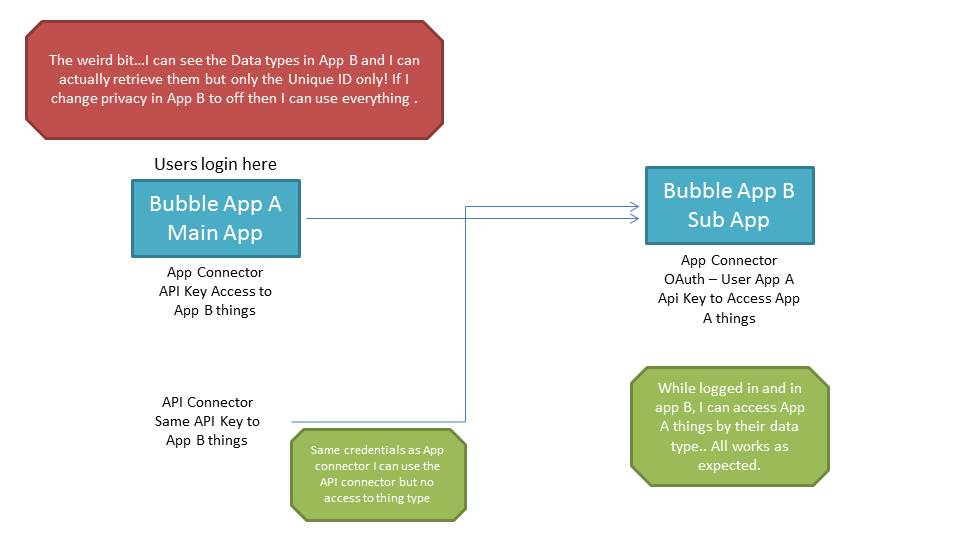

@dan1 question for you… Does there have to be any special privacy settings? For example… I have 2 bubble applications connected… I also have the API connector set up using the same credentials and calls. When I use the app connector to retrieve data in the 2nd application the only way I seem to be able to have access to it as if I make everything available to everyone… Whereas the API using exactly the same credentials and calls works without any issue
In the bubble app connector you need to specify your using a API Secret
@robertjhill0 yep got that thanks i am referring to bi directional access. App B the sub app which is OAuth i can place the api key Client ID and secret …get all my stuff in app a no problem…but and here is the thing… in app A you can only put the token with authentication as API key… this is the issue… i cannot get my data in app b unless privacy is off. but using the same token in the API connector works.

Might be helpful for me to understand if you draw it as a diagram. (App A and App B - what’s being shared, who’s accessing what form where).
This all works but when it comes to using things in App B you can only access them as their Unique ID…funny if you turn privacy off in App B then it all works…“yes i know about privacy settings in general and in regards to api calls” The exact sames calls in the API connector using the same credentials work fine but you cannot access the data type of course.

Thanks Dan, yes Inspector and console too. Interesting you mention “Are you referencing nested objects” that seems to be the nub of the matter… not an issue with the native API connector which is what i cannot get my head around as i presumed they two are pretty much the same.
…so my intended outcome is to get a list of things …these things have their own DB type and i assign these to a user as a list of things…
So as as example
Whilst in app B
I can get a list of users in App A (super)
I can get a list of all things in App A (going well so far)
I can create a RG of users and get a list of the things when the RG type is user (outstanding)
Now if i set the RG type to the thing which i need to list (bearing in mind i can create a RG of these things for all users with out an issue) I get back a big fat zero… nothing in the inspector.
If i make the same call via the API …it works.
are you aware of an issue when referencing stuff in nested objects via the App connector
@dan1 just for completeness… as i can list all the things in app A from app B i can filter these to current ‘app b’ user …app A user if that makes sense.
