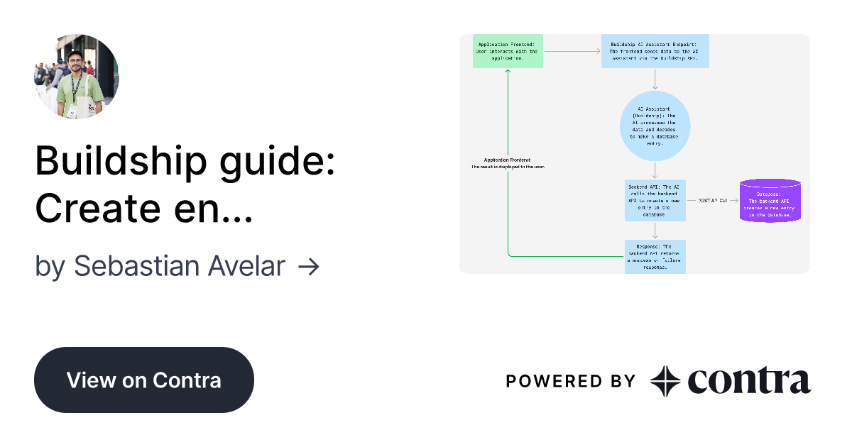

Hey @bwm561 @franklyn1 I made a guide here explains how I do this in my Bubble app:
Pretty much you need to make a backend workflow in you bubble app that can be triggered by an API call.
You could set it up to be a Get call and return the value of whatever datatype you need.
Then the Ai assistant can have a function that makes the API call to your endpoint and gets the information of it before answering a question or other use case you may have :slight_smile:
Let me know if you need further help!
Thanks for your response @design.agx ! But not entirely what I’m looking for but is a perfect solution for @bwm561 . In your example, it’s seems like standard function calling which I’ve already figured out how to do. You have an API that does something specific (replace pokemon) (and also used a 3rd party tool which I don’t think was entirely necessary :slight_smile:) where in my case, I would need an unlimited amount of functions to return values for all different types of user questions since the data would live across multiple things.
