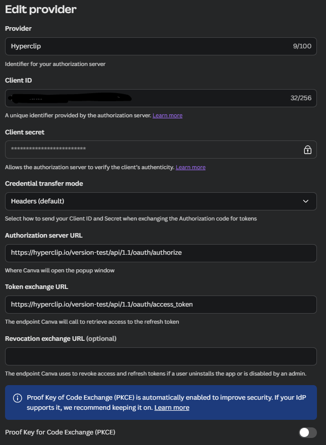

Configuration:
I’m using the bubble API settings to create a 3rd Party App, which includes the return URI: https://www.canva.com/apps/oauth/authorized
Then I’m using the Canva App authorisation settings to align with Bubble which includes the Authorize and Access Token end points urls:
