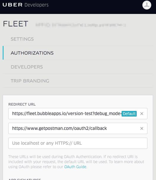

I’m having the exact same problem with uber. I get the following:
This is the page the request comes from:
I’ve entered the same thing in the developers’ dashboard:
In the workflow, when the button is pressed, it’s set to “Signup/Login with a social network”. I’ve chosen the Uber API
This is the same configuration as the AirDev Uber example, but I keep having the same problem.

On the top right there’s an instructions button which includes screenshots of the redirect URIs to be setup in the uber developer portal. Feel free to check out the api calls as well.
@scottb50,
You’ll need to put in all combinations of the url in uber similar to the one demonstrated in that screenshot. That should be somewhere around 6-10 redirect URIs I guess.

I think I’m making progress here. I removed the variables and am no longer getting the error.
Fix: Uber calls for URLs in the Authentication area of the admin and URIs in the documentation.
