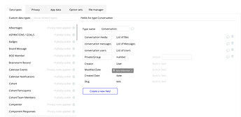

What I am trying to do is let the Current User go into messages and send a group message to multiple users. So let’s say I am current User and I want to message Doug and Tyler. So the first time I want to do that it simply creates a new conversation with Doug, Tyler, and myself. A few months go by and I want to message you both again (and for our purposes let’s just imagine that I forgot we had a group message before). So I go to message you both again by creating a conversation.
What I want to happen is if a conversation already exists like it would in that situation, it doesn’t create a new one, but just recognizes the existing one and opens that.

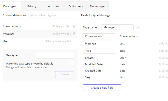

How is your data set up? Cuz if you have a data type of Conversation that holds the User’s and a Message that ties to the Conversation, hold the message and the type of message, it should get your close.

Haha you are definitely right on that. It started simple, but has gotten pretty crazy trying to make this work. The data setup is pretty similar to yours though:

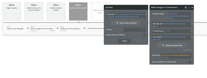

OK. TRY THIS
First, I had to find a way to add users to the convo but not start a convo per se
add user convo ui
Now create a new message without any conditionals
Now create the convo conditionally
Here is the conditional
So I created a temp list I’m adding users to to create the convo. Later I’d delete the list so I’d be able to start over.
To avoid sending a msg twice, you’ll make sure the make changes to convo that’s > 0 is first in the workflow.

Yes sir you bet. If I could steer you one way of creating a msg feature. It would be to setup the data structure the way I presented earlier. It should save you tons of headaches. Non-the-less, there’s more than 1 way to skin a cat
