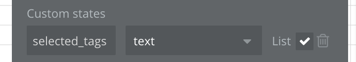

Just to satisfy my burning curiosity, would you mind sharing a screenshot of the This Page’s Hobby_Scan_State_Languages custom state when you get a chance? (I mean a screenshot of its definition.) I think that would help me understand.
-Steve
Sure. It’s a vanilla list of texts.

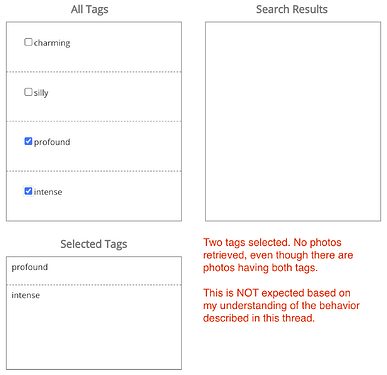

While I’ve gotten Bubble to accept the “list contains list” expression (by using the Text primitive data type), I’m not seeing the behavior you describe. I’m wondering if you can help me understand. Here’s my setup…
“Photos” data type having this field…
tags
Custom state…
Search constraint…

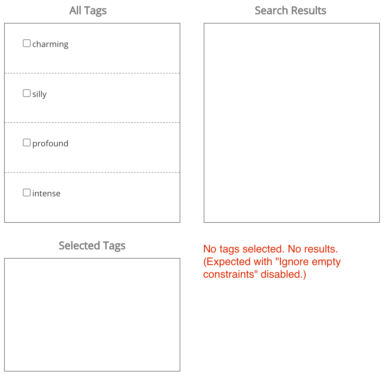

No tags selected…
One tag selected…
Two tags selected…
In fact, any time more than one tag is selected, no results are returned at all. I’m a bit perplexed and hoping you can shed some light. Where am I going awry?

Very nice screenshot layout, a lot of the “dumb” pointers can be immediately ruled out just from looking at it. First up, you definitely have a problem more systemic than the behavior of the “contains” operator on list vs list. The give-away is the “That Place” element should’ve been returned even if “contains” was behaving exclusively instead of inclusively. The comparison isn’t working at all.
