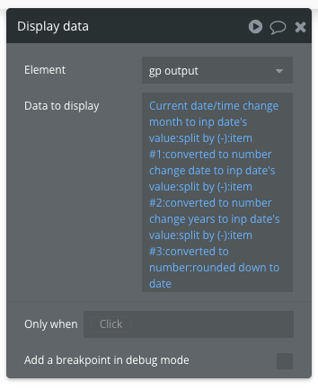

You can do something like i did in this example:
Link to editor: Rrdev-tips | Bubble Editor
Demo: https://rrdev-tips.bubbleapps.io/version-test/date_converter?debug_mode=true
