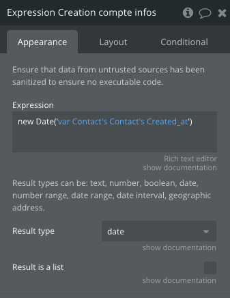

You also can use toolbox plugin then an expression, as shown of the screenshot below. You will need to use a bit of javascript but this works very well.
You need to use expression’s result where you want to use converted date.
Note that you can use server script from the same plugin if you need to do the action in the backend.

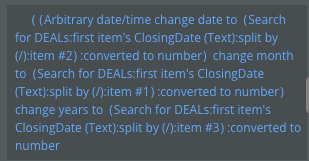

Could you share what that javascript is? Would like to use the expression element to do this.

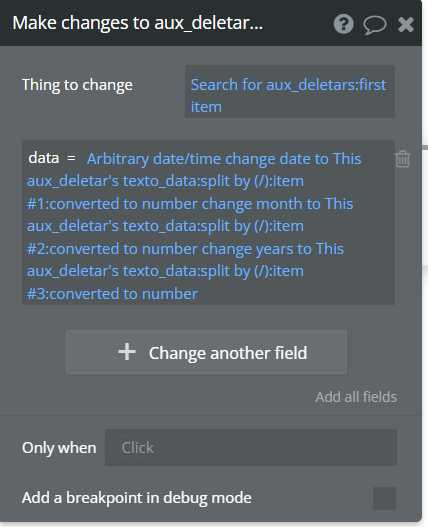

use o arbitrary date/time e depois mude o dia, mês e ano com dados do texto.
ex.: 01/01/2023 split ‘/’ = 01 , 01, 2023 . item 1 = 01 item 2 = 01 item 3 = 2023.
não esqueça de converter o texto para numero
Sensacional fórmula! Funciona perfeito! Parabéns! (realmente uma fórmula surpreendente, eu nunca iria pensar nisso! SHOWW)

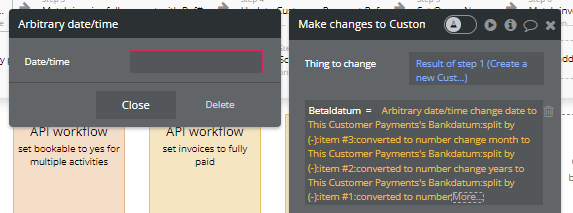

hi - thanks for this.
However, I get an error telling me to fill out Date/time?
Screenshot 2023-11-09 144613
Hi Christina, you can put whatever you want in there, since it will be overwritten by the rest of the command

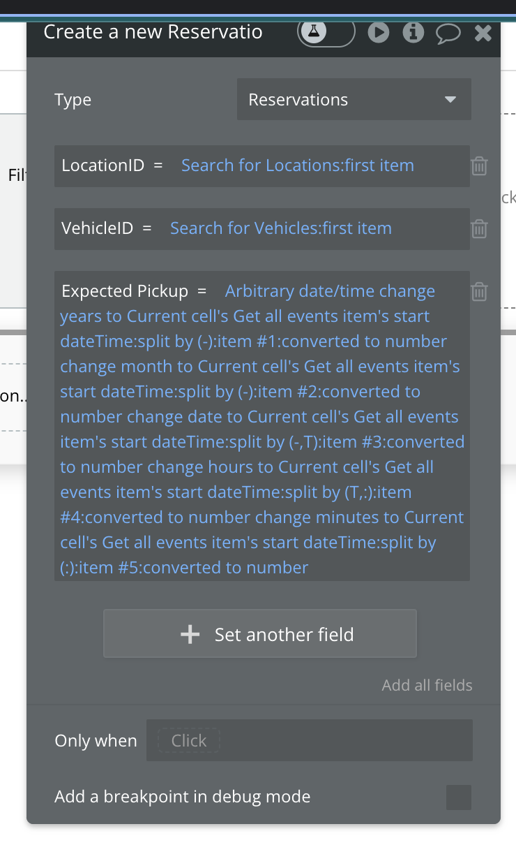

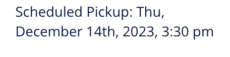

Hi! This kinda works great but the hours aren’t transforming correctly. Maybe this is a timezone thing? Could you please look at what I’m doing here?
I get a timestamp back from Google’s Calendar API: 2023-12-14T10:00:00-05:00
I’d like to save that as a date/time. So, I’m doing this:
But I get back this:
Screen Shot 2023-12-14 at 6.53.14 AM
So, net-net, the time Google gives me is 10am, but the time conversion spits it out as 3:30pm
