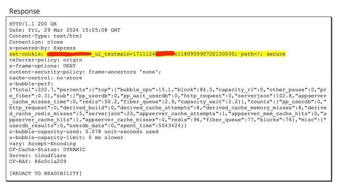

I am using the version 17 of bubble and for now we cannot update the app, but the security team asked to enable the cookie httponly flag.
Is it possible to solve this vulnerability without upgrading or is it mandatory to update the app and the problem has been solver in a newer version?

We tested it and the cookie does not have the HttpOnly Attribute.
Perhaps I don’t understand the cookie to which you refer. Not to worry - Bubble support will happliy answer your specific support enquiries. :slight_smile:

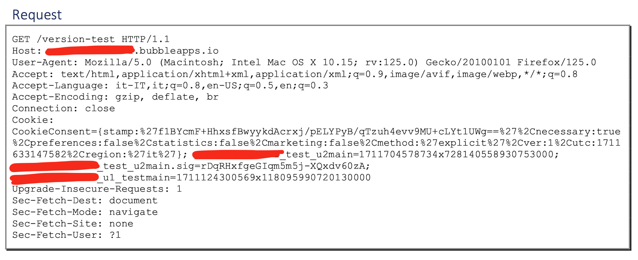

The external company that did a security audit said they did not found the httponly attribute in the cookie of this response:
They requested that we add the attribute. If it is enabled as you said, why doesn’t it appear in this response? Does it appear somewhere else?
