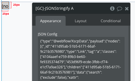

It appears that way. I pasted the JSON array into your plugin, created a workflow on button click, added a workflow step with a copy to clipboard plugin, and selected the ID of the JSON.stringify element to paste to clipboard. See attached. Not sure if this is the right way to do this.

After clicking the button and paste to the following tool, it appears to be null:
Hey! I’ve just released a patch to make it work as expected. Please let me know if that fixes your problem! :slight_smile:
