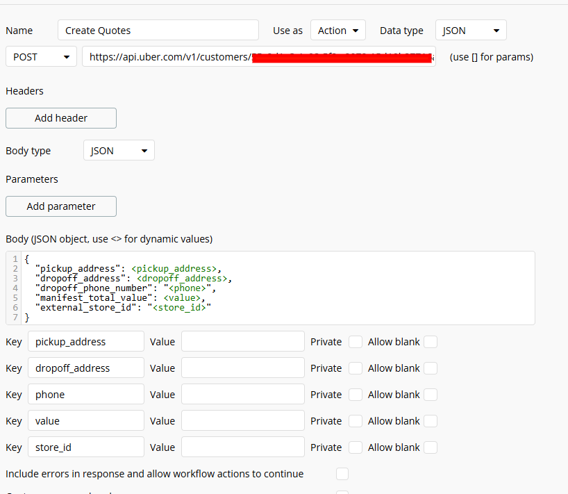

Here’s my settings that work
You can dynamically populate address part
I usually use formatted as json safe and use this find and replace with regex to remove the " that the formatted as json safe adds
There’s no reason to remove added "… if you don’t need them, don’t set them in the API connector. This make thing overcomplicated where there’s no reason for that.
Hello guys,
I finally got it! Thank you to all the replies. The solution that worked for me was to use arbitrary text and manually write the escaped string as seen in the picture, then using dynamic values. Since in the API body I have the pick_up_address and dropoff_address fields with " I did not have to add :formatted as JSON-safe after the arbitrary text so I can avoid double quotation.
Again… this way to do thing could lead you to error in future if, for example, you need to have to escape a characters in the address city. This will not be handled by your settings while my solution will not fail for that… However, there’s not a lot of chance for this kind of fields.
The correct way to escape JSON in Bubble is to use (correctly) formatted as json-safe.
