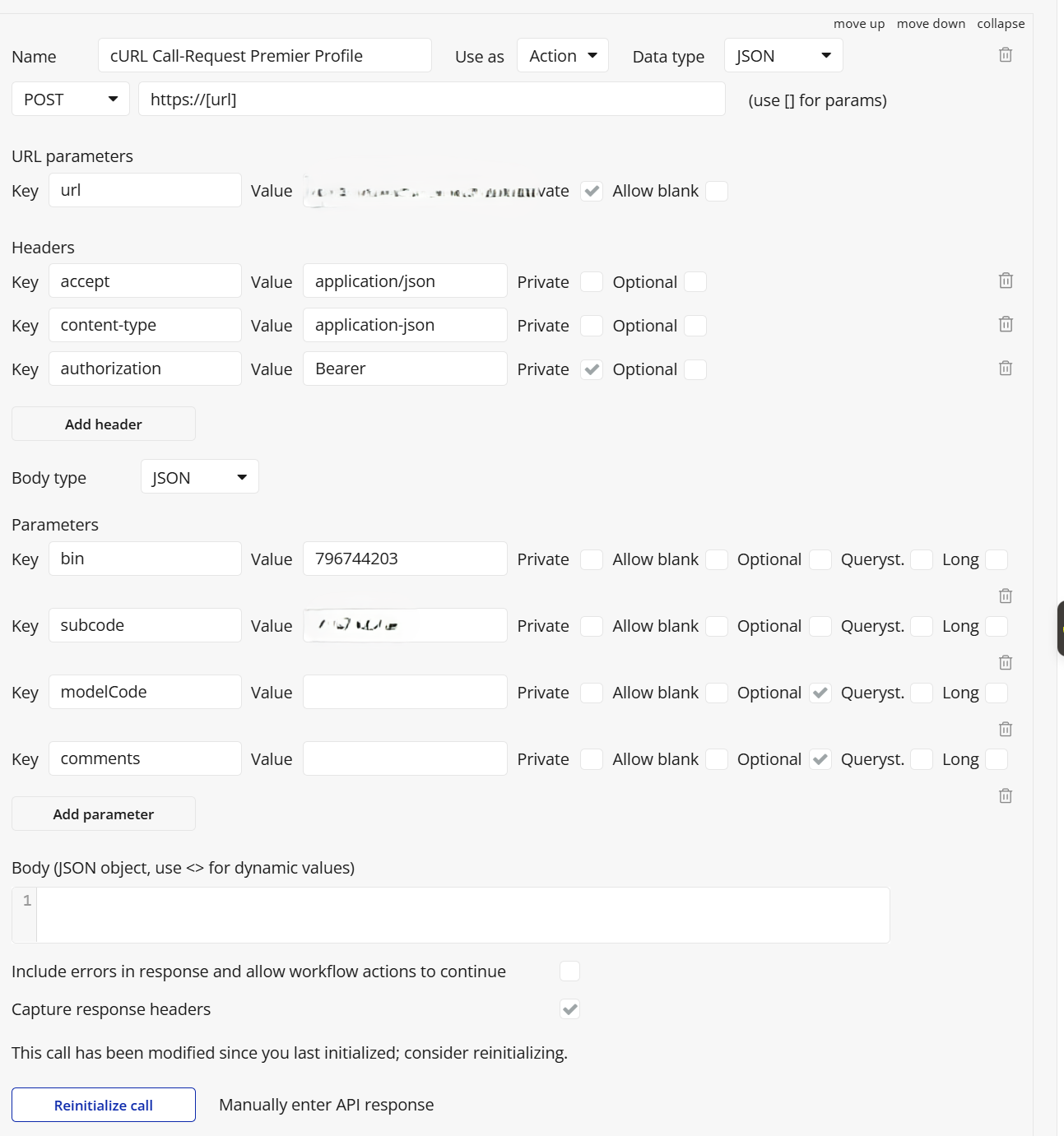

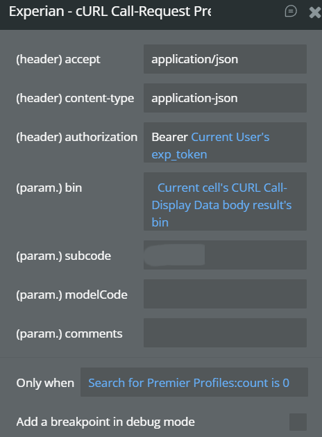

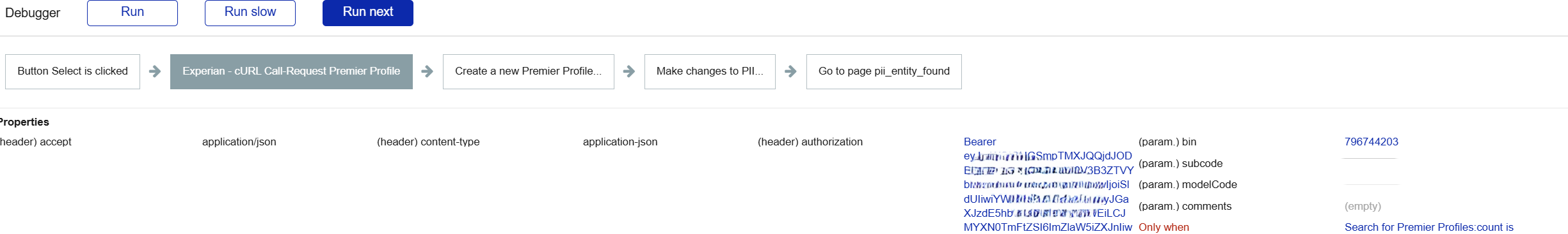

Here ya go. API call in the connector that uses the fetched token, the workflow on the page after the button is clicked (i chose a non-backend one for ease) and finally heres the inspector view of it running. I can confirm the token is successfully fetched and saved without issue in the DB. In terms of privacy, this is a current user running the workflow and the current user has all permissions. The error received says access unauthorized, and in the logs i dont see the token passed. If i set the api connector call (parameter for the token to “not private”) then i can track this and it will work but that gives me concern for obvious reasons. Info redacted where appropriate.

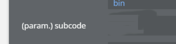

Private API connector values don’t show in the logs by design. What’s this? I thought you were fetching the token from the Current User? You’ll need to provide some detail about which token is the one you’re trying to provide dynamically etc because when you cover up everything there’s no way to know if there’s a static value, dynamic data source or something else underneath.
You have also an error on content-type that should be application/json
Are you calling your own app?

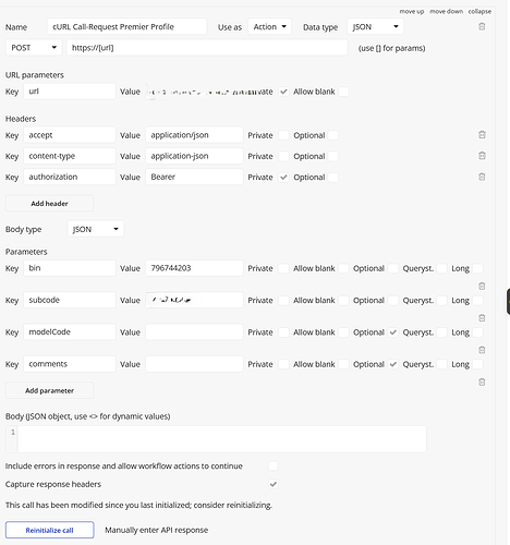

subcode is not an access token, its a private code we use related to the api were calling so i blurred it out. The access token is being fetched from the current user, but yes but by design i cannot see it in the inspector or logs. It is the current users token though. Here is a screenshot from dev environment without the private for the token checked so you can see. When the private setting is unchecked at the api call level, this works.
Hum… you need to set uncheck private checkbox! This has not changed. This is what you need to do! Don’t be scared, the call is made from server. However, you need to make sure privacy rules allow access only to the user that own this key.

If you can (for example, you are using only your own API key) you should set this to private. But when you can’t like your case, you need to use the correct privacy rules but leave the private box unchecked
