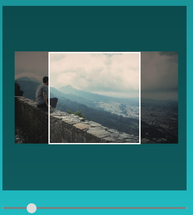

I am using the Croppie plugin to crop images. Currently the maximum Zoom out I am able to do is until the Viewport reaches either Width or Height. I would like to Zoom out further and fill the blank space with White (or transparent)
For e.g. My crop should look something like this with white space on top and bottom.
And not like this
Is there any way we can do this? I have created a page in Open app to depict this. Please help

@anshuk Yes the library has an option for this.
I’ve updated the plugin to v0.6.0 to allow you to use this option “Enforce Boundary”, although I don’t have time to test it on all the various browsers. Please report back with your results.
@mishav, Thank you for your help here. However, I am unable to see the option of “Enforce Boundary”. I have updated the plugin to v0.6.0. See the image below. Is there something I have missed here?
If its not showing (underneath instance timestamp), you may need to refresh or reopen the app editor to pick up the change.
@mishav, it works. This is exactly what I needed, appreciate your help here.
