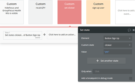

Yes, here’s the workflow for button being clicked:
For set-clicked (1st custom event):
For sign-up-user:

Actually, I’ve figured out what the problem is here… and it’s got nothing to do with your workflow steps running out of sequence (which they aren’t)…
The issue is because of the way you’re trying to validate the input.
If the input is not valid (i.e. if it’s not a valid email address) then the workflow will not run at all when the button is clicked.
If you want to override the default Bubble validation on an email input, you’ll need to switch the input type from email to text, and handle the validation yourself.
