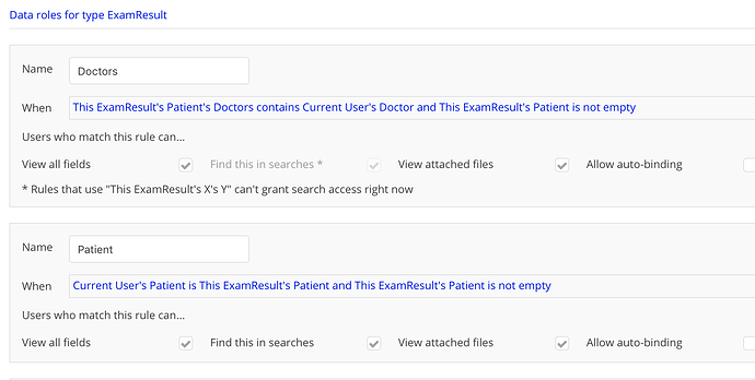

Hi @rscestari!
Is it too late to make data structure changes, eliminating the PatientDoctor thing, and having a many-to-many relationship on the Patient and Doctor things themselves?
Something like this:
And then add the doctor and patient records to the user:
And setup privacy for patient and doctor on the Exam Results:
The check for is not empty, is just in case you end up with a User with an empty patient record, that would then match to any ExamResults that also do not have a patient attached.
Now unfortunately, for the doctors permission, you can’t use the searches (as noted in the screenshot,) but it still might work for you. For example, if a doctor user searched for a patient, then all the patient’s ExamResult’s would be still visible to the doctor.
Hopefully this stirs up some ideas for you!
