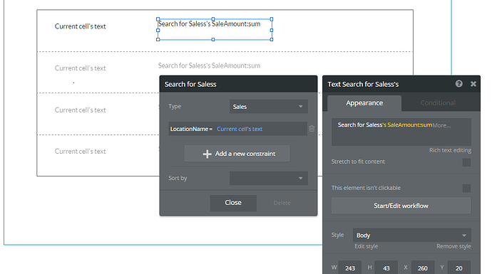

Simon,
If I understand your question correctly, It’s been something that I’ve been struggling with for quite some time. From having a SQL background I believe you’re basically asking how to perform a GROUP BY clause in your query and also implementing a function [like SUM() or COUNT()] on whatever specific data you’re selecting. To make your example for just sales by location a SQL query would look something like this:
SELECT LocationName, SUM(SaleAmount) FROM sales GROUP BY LocationName
I have not found a manner to accomplish this in Bubble with a single select. I hope there is a better way, but to do this (with the same example) I’d create a repeating group object with a data source of Search for Sales’s Location:Unique Elements. This essentially performs the ā€œgroup byā€ operation. So the first text object in the repeating group is simply Current Cell’s text which is a list of distinct values. In this case the distinct location names.
From there each additional text field to display in the repeating group is a new search based on the Current Cell’s text. For example, to list total sales by location the next text field in the repeating group would be a Search of Sales SalesAmount:Summed where LocationName = the Current Cell’s text.
From there, you can repeat this logic of new searches where LocationName = the Current Cell’s text for each text object to display in the repeating group.
At least this is the way I have been doing it. It does not seem very efficient to me. That is, each object in the repeating group is performing it’s own independent query. The biggest limitation I see for this is it depends on a repeating group object being displayed; which I imagine takes more processing than calculating everything in the backend and simply displaying the results to the user. I’ve tried to do similar calculations through Workflow only, but have not been successful.
