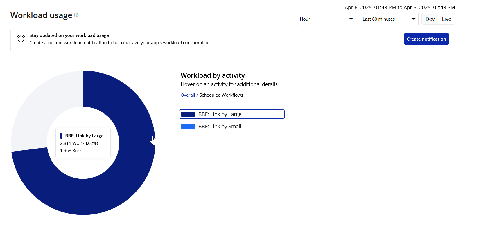

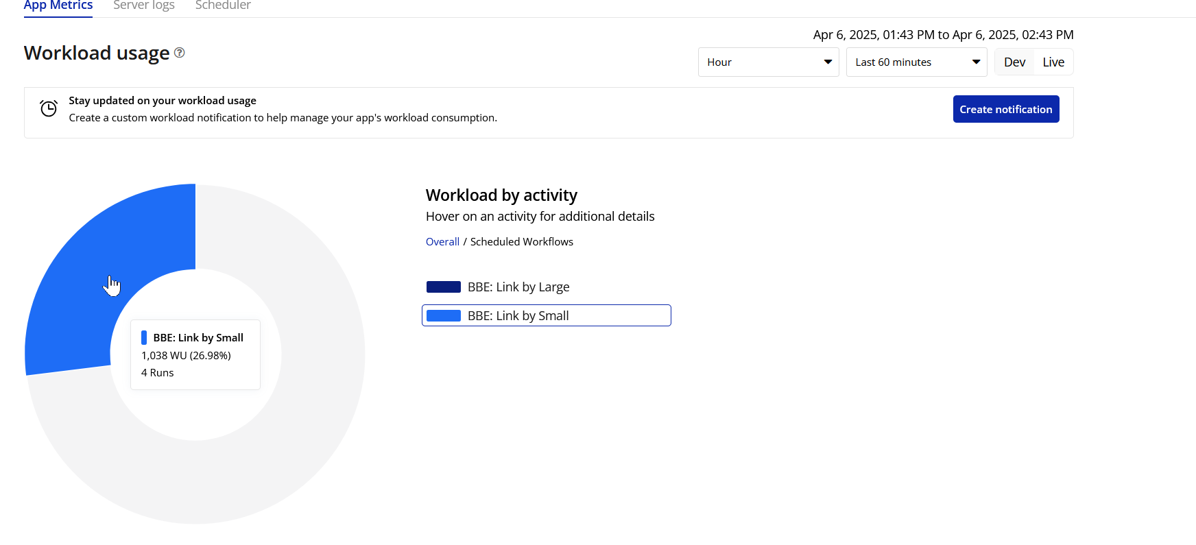

So first of all let me say that the WU units is all over the map when I do a different amount of records (lets say 600 instead of 2k).
But the instance where the number of WUs for the Link by Large WF and the Link by Small WF were closest still had a significant gap (and more than I expected and that one would expect based on @georgecollier breakdown (which is correct, technically, but in real life…). In that instance, the Link by Large WF used 2,811 WUs to updated 2k records while the Link by Small WF used 1,038 WUs to update 2k records which is 63% less Workflow units!
Here’s some screenshots:
Link by Small WF
Link by Large WF
WU Used
PS, it’s really more than 2811 WUs as that chart is only missing 37 of the runs somehow even though the logs show it was ran 2,000 times
