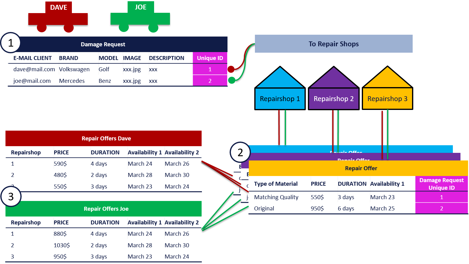

Hi guys, I am having trouble figuring out how to organize my database, so I made this image to clarify everything a bit (maybe it only confuses even more but here we go):
If I understand it correctly I´m trying to build a one to many relationship within my database: A client can make multiple damage requests and each damage request can receive multiple offers. However, each repairshop can only make one offer per damage requests.
One Damage Requests – Many Offers, Every Offer only One Damage Reqeusts.
Where I get lost is how to structure this within my database. I structured it now how can be seen in the image, in which I incorporate the type “Damage Request” as a value in the type “Repair Offer”. As such every offer is linked to a unique Damage Request ID, and I feel it should be like this more or less.
I created a page for the Client in which I want to show which Damage Requests were issued by the Client (Through a repeating group) and then, when selecting a certain Damage Request show, again through a repeating group, which offers were made by Repair Shops. Dave would select Damage Request with unique ID 1, and then see offers from repairshops 1,2,3 respectively, all linked back to him through the same Unique ID which was incorporated as a value within the “Repair Offer” type.
My problem is filtering on the unique IDs which belong to Dave. Let´s say Dave created a request with Unique ID 1 (image) as well asUnique ID 3 (not in image). I would like to make a filter so that all Damage Requests made by Dave will show up in the repeating groups, which subsequently can be selected to show the (in this case 3) offers made by the repair shops.
I hope I made myself clear enough, if not just let me know so I can clarify the situation a bit better.
Thanks a lot!
If I have understood you correctly, I would do something like this:
  • User {email; type; etc} - type can be client or shop
  • Request {requester(User); etc} - requester is the User (client) that placed the request
  • Offer {request(Request); shop(User)} - shop is the User (shop) that made the offer
Your repeating group for Dave’s requests will have a content type of Request and a source of Do a search for … Requests, with Constraint: requester = current user (assuming Dave is the current user). If Dave is not the current user, you can use Current Page User and send a selected user (e.g. Dave) to the page. If you need to refer to Dave by email/unique id, you can of course do this too in your constraint.
Now, the above is a very relational database way of doing things. You may find as you go that you need to add Offers as a list field to your Request table, as it may make it easier to display a list of offers for a request. Personally, I tend to like my databases normalised, so I don’t roll like this :slight_smile:
I hope this helps.

That last line was just me acknowledging a method that I have seen people recommend a lot, here on the forums, where you have a field that lists a number of related items. It makes sense to do this in some cases and given the way Bubble searches work, it can make things more straightforward. If I were doing this, I would structure the database as I laid out in my bullet points, and then if I got stuck (when doing searches), I would consider adding offers as a list field in Request and possibly other changes.
To be honest, I found it a bit difficult to follow your diagram, sorry. I looked more closely at what you described as your objective and outlined how I would approach it. You may want to compare your approach with mine - perhaps they are already very similar.

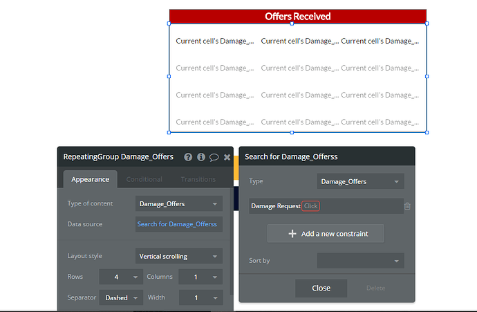

So I can´t get it to work somehow, it´s all good and well, I´m just still not able to filter all of the repair-offers so that the user will only see offers on damage requests that he or she made.
http://pietjepuk.bubbleapps.io
Could you (or anyone else for that matter) maybe have a look in there to see what I´m doing wrong? This is not my real app by the way but just one I use to test all these functionalities, so don´t get upset with the design etc. haha
Please share a link to your editor.
You need to put a constraint on your search. Right now it’s bringing back everything.
Based on your data structure, there are two ways you could do this I think:
  1. Do a search for offers - constraint: request is in (do a search for requests - constraint: user is current user). This method doesn’t make use of the offers list that you have in the request table.
  2. Do a search for offers - constraint: offer is in (do a search for requests - constraint: user is current user)'s offers.
I hope this makes sense. It’s late where I am but let me know if you don’t figure it out and I can make some changes in your test app directly tomorrow, if you don’t mind.
Great I´ll have a look there again then andwill give a shout if I still find difficulties. I was trying the constraint issue already just that it didn´t work out yet for me. Thanks!
So the issue for me right now is as follows. I added the type “Damage_ Request” as a value in the type Damage_Offers, and as such the unique ID of the requests which are responded to are visible in the table:
However I just can´t seem to find a way to link the Damage_Offers, through this unique ID, to the Damage Requests for which the offer is made.
I am simply looking for a constraint/filter to filter out just those offers which were made on requests made by current_user. Hope this makes sense.

I hope you don’t mind, but I made a quick change to your test app (added a constraint to your offers search). It should now be showing offers for the current user’s requests only. You should still carefully follow @romanmg’s recommendations though, to see where you may be able to improve or optimise your data structure and/or searches.

I just saw you made it work, really awesome!! Now what’s the logic behind the constrained is in? Is it to link the damage request value of the datatype ‘offer’ with the data type ‘damage-request’ in order to identify the user?
Yes, so the search is essentially saying find offers where the request (on the offer record) is in the list of requests made by the current user.
