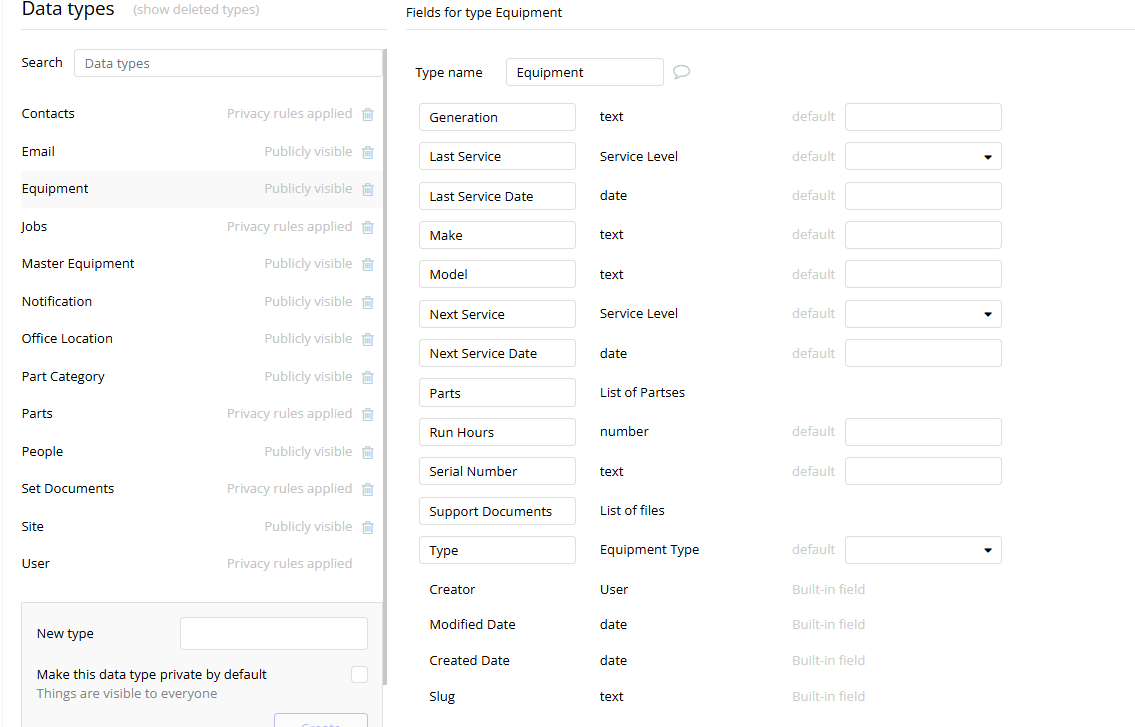

Could anybody advise how best to structure my database for parts needed for a particular service?
The links are pretty complex. I have a customer, they have sites, they have equipment, the equipment has parts. When a certain service on an equipment is needed, only certain parts are needed. It’s this link I’m not sure about.
Let’s say a machine has parts A, B, C, and D. On Service type 1, only A and B needs to be replaced, on Service type 2, A, B, C, and D need to be replaced.
How am I best structuring this?
