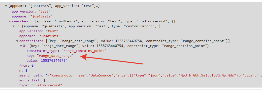

Looks like Bubble’s internal API supports the following constraint:

In case anyone needs this in the future. The constraint name is range_overlaps and the value is a list like [“start_range_date”, “end_range_date”] URL encoded of course
