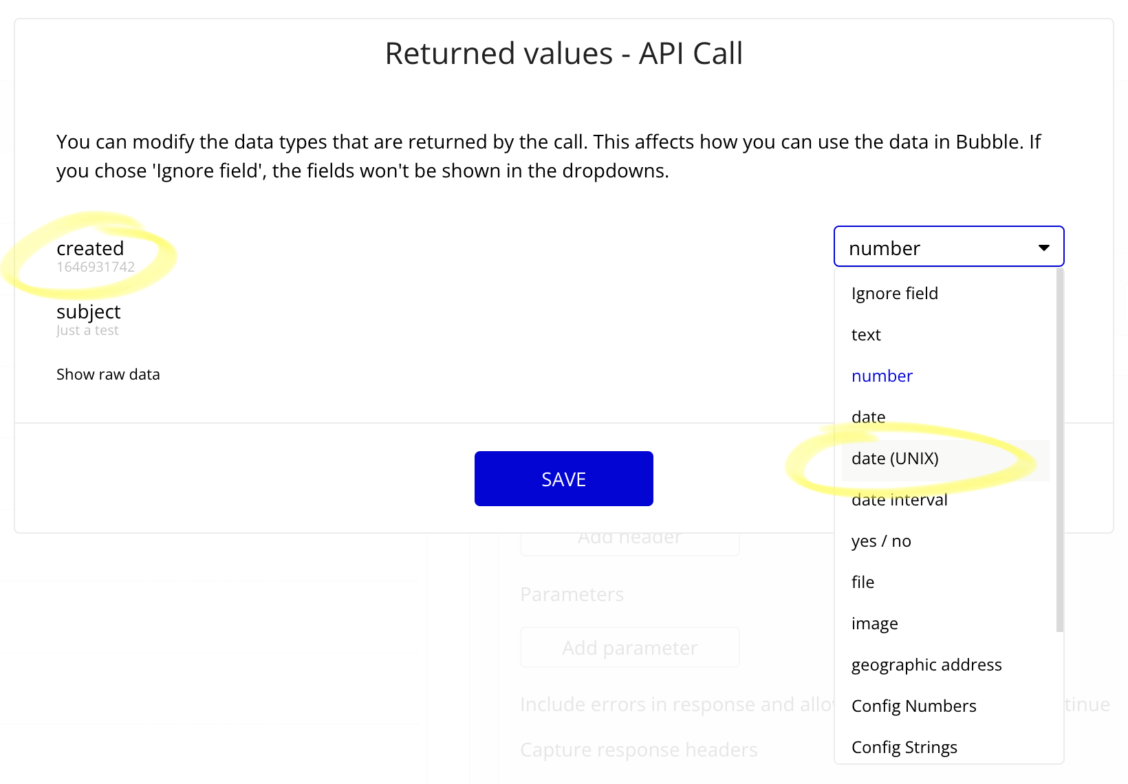

Hi @reidbrown23,
If you’re using the API Connector, you should be able to indicate that it’s a date when you initialize the call. Bubble will automatically turn it into a native Bubble date.

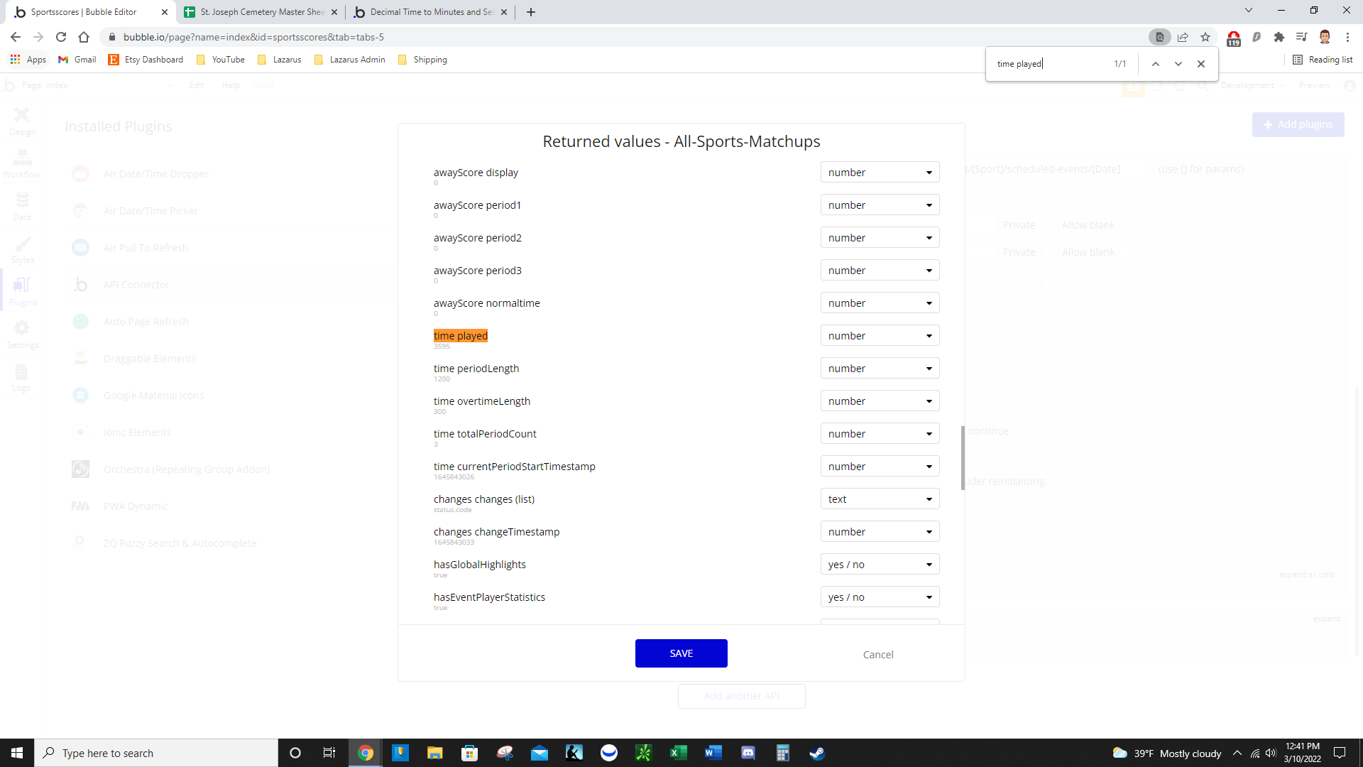

Hi @sudsy !
My apologies… It is actually is displayed as time played in seconds. Any suggestions for how to format it?

Oh, ok. That’s not a UNIX timestamp. That’s just a duration. It simply represents a certain amount of elapsed time.
Since you know it represents elapsed time in seconds, just divide by 60 to get minutes and use modulo to get the remainder in seconds…
elapsed_secs/60:floor : elapsed_secs<-modulo->60
That will give 59:55 for the value you have highlighted.
