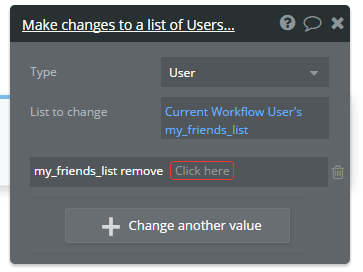

“Make changes to a list a things” is what you want, but it is a little hard to get your head round the first time so don’t worry :slightly_smiling:
The “list to change” is the field with the list of images. You then use the remove action to remove the image that is being clicked on.
So here I am “unfriending” someone. Removing an entry from the my_friends_list. I point to the list (which is on the user) and remove.
In your case you need to point the first box to the list of images and remove the one in the group.

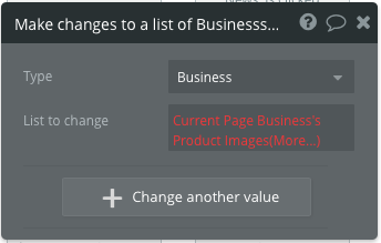

Makes sense. But here is what I get…
What does the error message say in the Issues Log ?
How is Product Images set up on the database ?
It says the list to change should be a list of businesses but it is a list of images.
Under custom data type Business it is a list of Images.
Your issue here, if i understand the situation correctly, is that the type of list you want to change isn’t a list of business, but a list of images. A better way to do it would be to modify the Current Page Business, and pick the field ‘Product Images’, and modify this in the ‘Change another value’ section.
Yes, that worked. Thanks.
