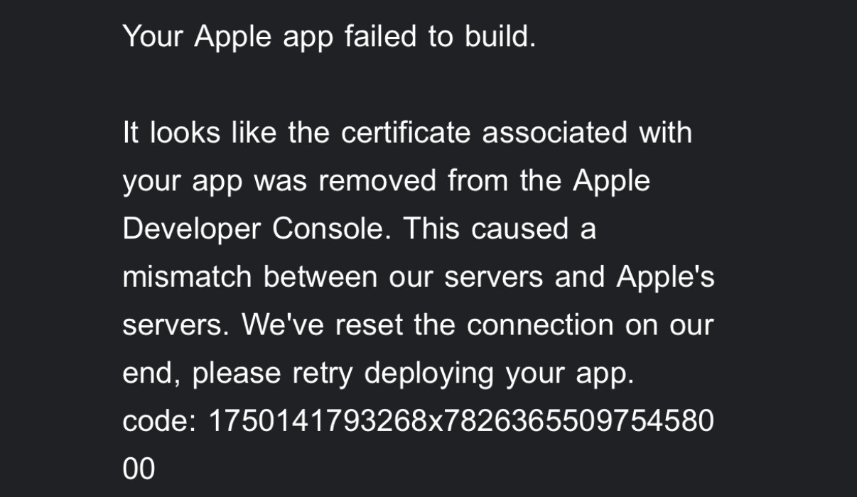

  5. I then deleted the distribution certificate(only after having seen your post in April about how we shouldn’t do that-- this should really be in the official support documentation under the distribution certificate section) and only after that deletion did I start getting emails from bubble again, but this time saying the certs didnt match.

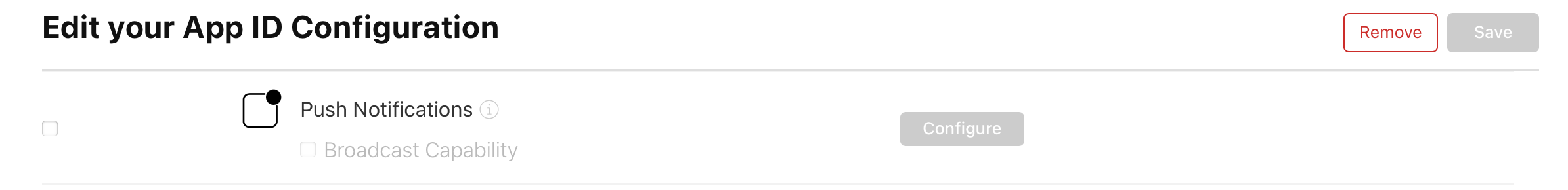

Did you also enable the Push Notification entitlement on your Bundle ID in App Store Connect? If not, that could be why it was causing issues with the build process
Are you talking about from the developer page, under Certificates, IDs & Profiles, when you navigate to identifiers → [your app’s bundle id] and select Push Notifications? If so, yes.
yes - ok good
I tried cloning app to see if you all would create a new certificate but I still got same error. Does this mean that my other mobile apps deployments will be blocked as well? @nick.carroll
You’ll have to be manually unblocked since the certificate was deleted. These certificates are linked to your account, not your app. We implemented some logic to regenerate one if it was deleted, but it seems that it isn’t working properly.
