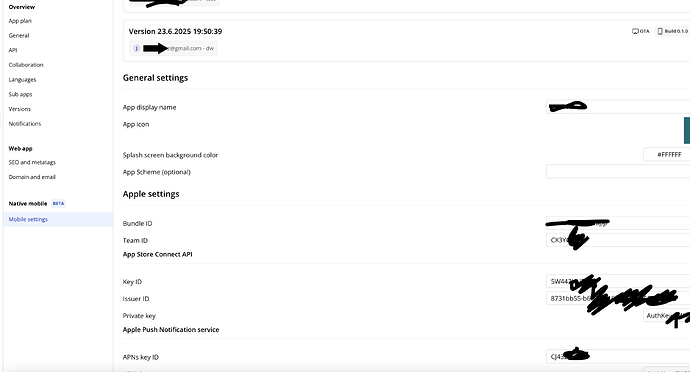

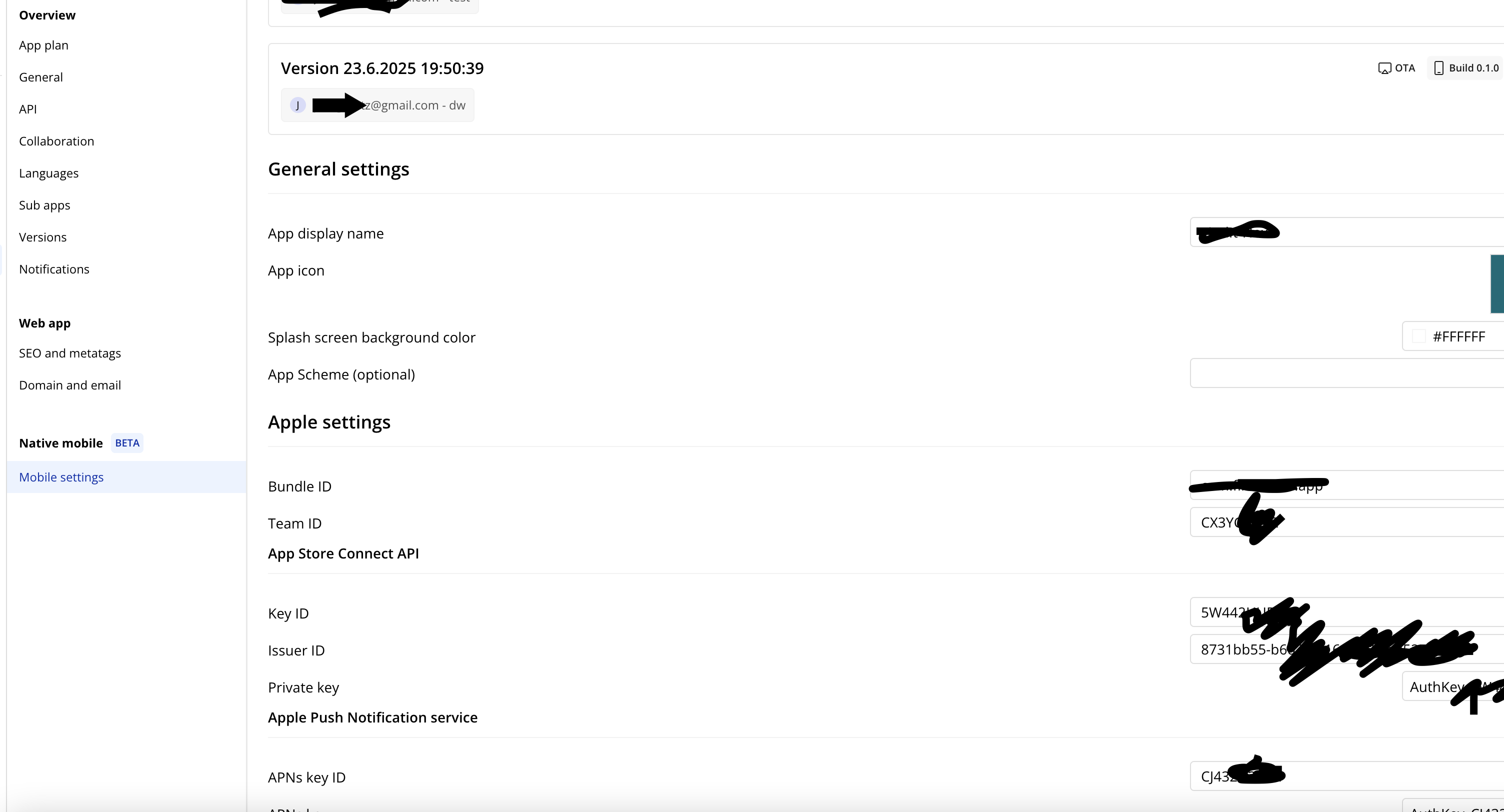

I also receive no emails (crash report or success message).
any idea?
best,
jupxi
PS: I also contacted the bubble support team, but no answer until now (waiting for long time).
→ I dont see any action regarding deploy process in the Logs System
It looks like your first deploy was an OTA deployment? I don’t think that’s possible to OTA update a non-existent app. I would try doing a regular deploy. This would still be a bug on Bubble side to prevent that action, but just throwing a thought out there.

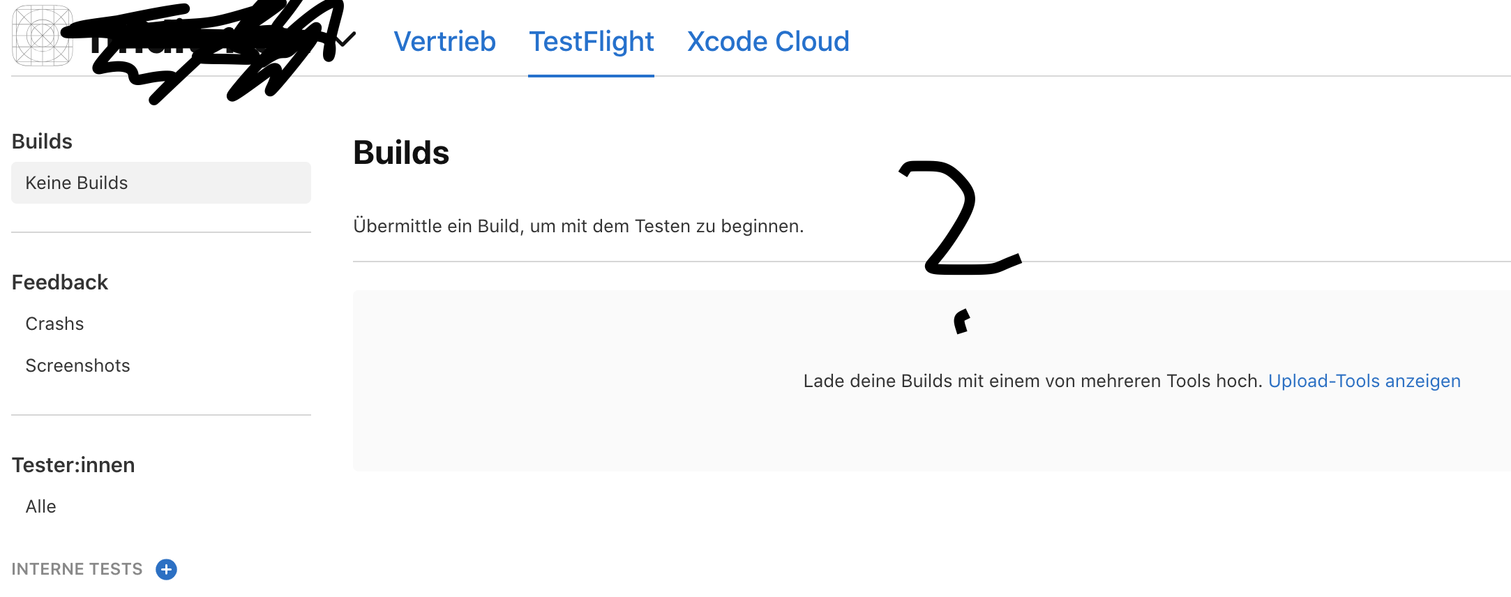

No, my very first deploy was a NEW BUILD. (I think this was the only possible item to select in first deploy). I have never seen any build in my Apple connect portal.
Here’s the answer and solution from bubble support:
It looks like your iOS app is using push notifications, but the Push Notifications capability hasn’t been enabled yet. To get this working, you’ll need to make sure that this capability is turned on in your Apple Developer Console.
