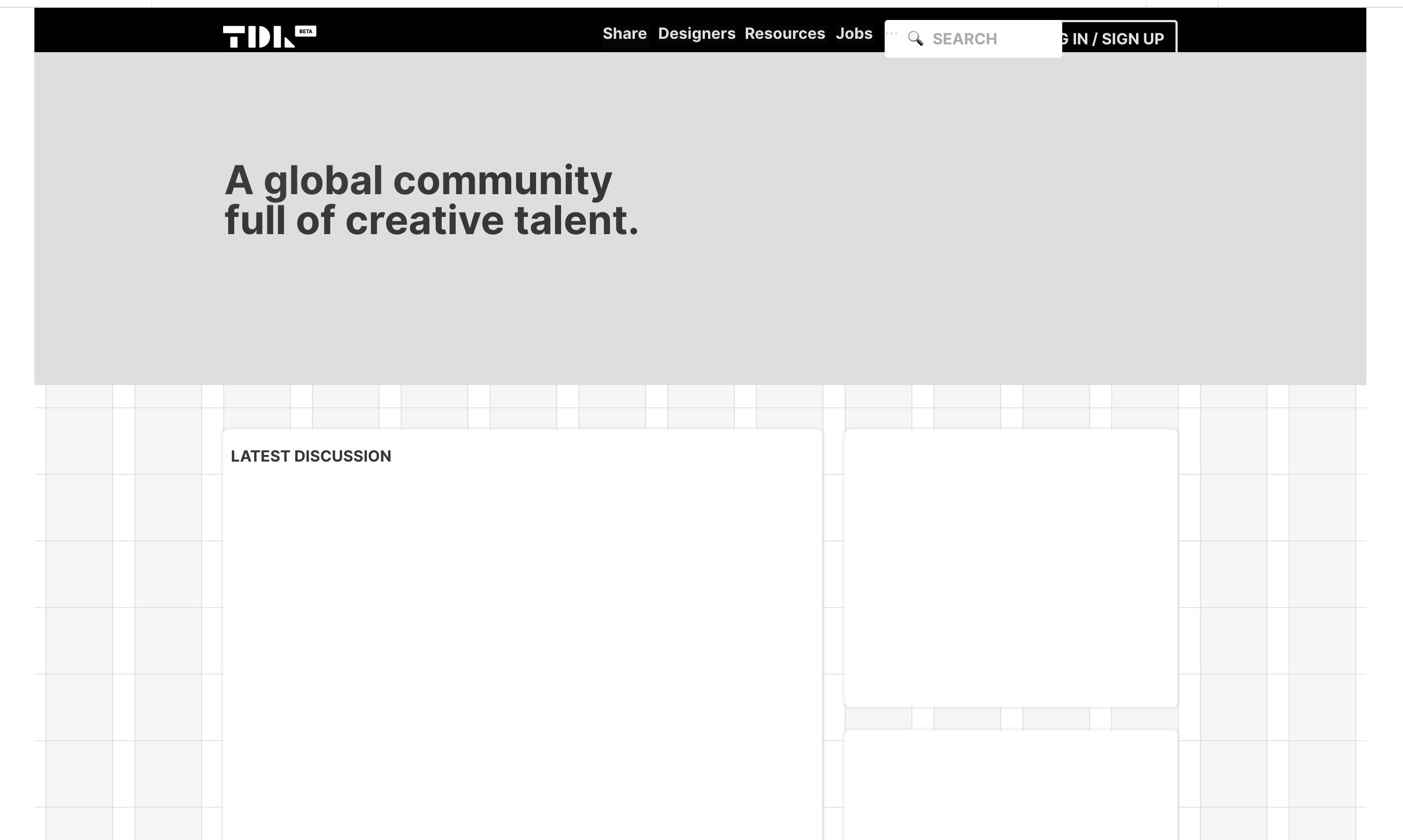

Hey guys, think I must be doing something wrong with the app width settings as I’m having to place items like so! I’m working on a 13 inch MBP!
Just to get results like so

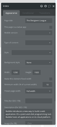

Any help would be appreciated - here’s my page settings

You need to put each section inside a larger group and set that group to 110% width so it would look good on large screeens and it will keep the content aligned inside the container.
Example
Header group full width 1200px > Inner group 1000 px and 110% max width > then you put your elements inside the 1000px container.
