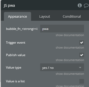

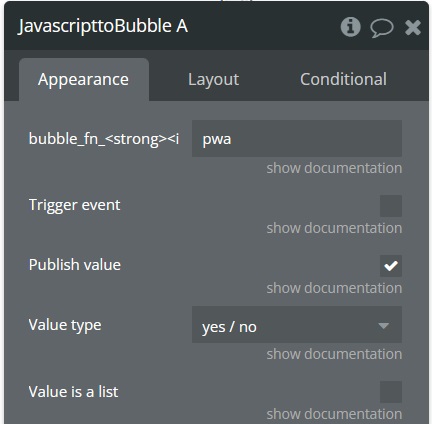

Since my app is supposed to run as an pwa, i would like to detect if the user is running the app in standalone mode. I am using the Toolbox with the javascripttobubble function, as you can see in the screenshot.
But somehow, i dont get a value back. It doesnt change at all. The return value remains NO.
What am i doing wrong?
Any hint would be appreciated!

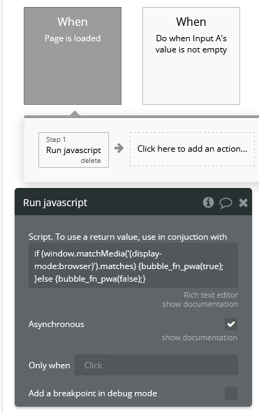

I spent a lot of time finding this… not sure why it was so hard.
if (window.matchMedia(’(display-mode:browser)’).matches) {bubble_fn_pwa(true); }else {bubble_fn_pwa(false);}
Works fine (note I have browser in there, you can put in standalone also of course)

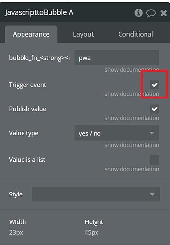

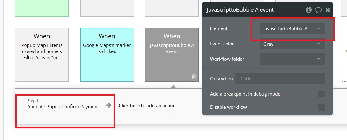

.matches already returns true of false, so that’s not the issue. @Phil83, note that the value will not instantaneously be available, so if you’re expecting JStoBubble’s value output to be populated in the next workflow step, it won’t be.
What you do is select the Trigger event option in JStoBubble and trigger a workflow based on that trigger from JStoBubble. That event triggers once JStoBubble has published its value.
Hi Keith,
thank you for your response on that. I followed your hint, but still no success. I dont know what i am doing wrong (see screenshot) but it still doesnt detect the standalone mode.
You sure my solution doesn’t work? It worked on my PC
Hi Troy! Thank you for your response. I tried your solution, however it doesnt work :smiley:
I tried it with Chrome, Safari and Firefox. All in browser and standalone mode. The Return Value doesent change at all. Could you add a screenshot of your workflow Run javascript?
Hope this helps.
if (window.matchMedia(‘(display-mode:browser)’).matches) {bubble_fn_pwa(true); }else {bubble_fn_pwa(false);}

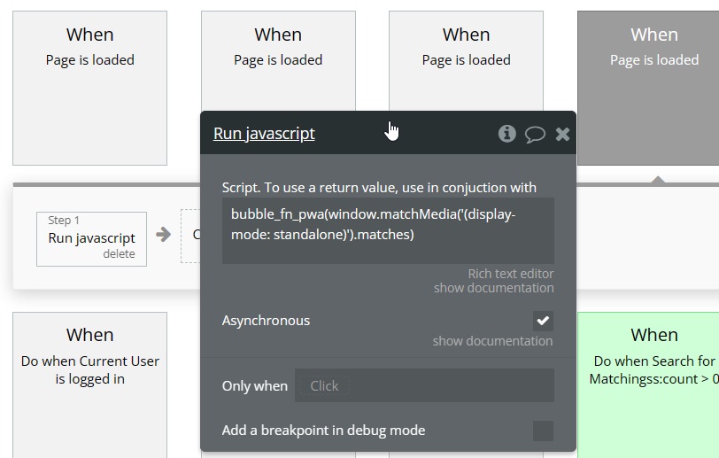

Here’s the exact code you need in your Run JavaScript action:
bubble_fn_pwa(window.matchMedia('(display-mode: standalone)').matches)
Hi Keith. Now it works apparently.
