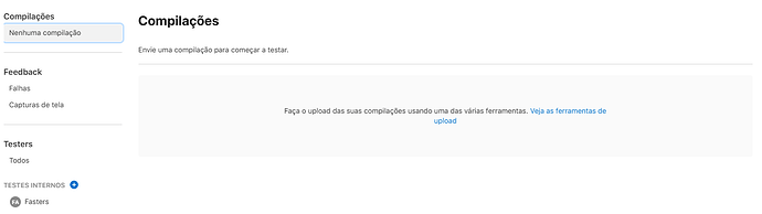

Are you mean this test informations tab?
No, above, where it says “Testers”, you have to add internal testers, make a tester group by clicking a plus on the button above, give group a name (e.g. Testers), and click create, then, click on the group you just created and click plus near the name of your test group, and add yourself! :slight_smile:
Right
But the problem is that there is nothing on TestFlight. 0 compilation to test. I dont know if it is a problem on deploy or something that I did wrong. What do you think?
