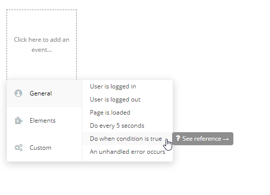

  1. Create custom event with your calculations (after change) image
  2. Add a listener in any workflow (could be your workflow button, the “do when input’s value changes” or a “do every”.
Should do the things you need the things to do. Let me know if it worked or if you want me to check it out.

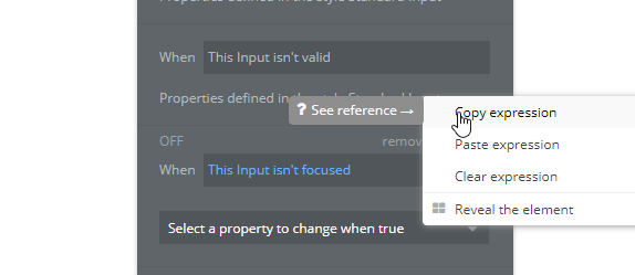

  1. image
  2. you have to copy/paste this expression from the DESIGN panel (you can’t access it from the workflow and “buyer beware” this may break in the future as I’ve heard that it isn’t “officially supported”. But credit to @petter who is a god to me now for teaching me this. (P.S. don’t use “this input” but the actual name of the input)
Add your calculation to that workflow. MAKE SURE TO SELECT “do every time”. Or you will spend 40 some minutes wondering why you’re an idiot even though you’re not. Or maybe that’s just me.
Cheers
Paste expression in that red square. If that wasn’t clear.
