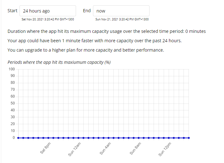

  • What’s your app capacity looking like while this recursive backend workflow runs?
    See below for my app capacity.

Instead of the workflow graph, can you check the ‘Periods where the app hit its maximum capacity (%)’ graph? Also check how many minutes the app hit its maximum capacity usage. See below for an example.
