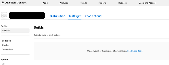

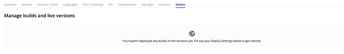

I am trying to publish a first version of my Bubble mobile app to the app store. I followed the steps in the documentation iOS/App Store | Bubble Docs but my Bubble app isn’t connecting to my Apple app.
Am I missing something?
