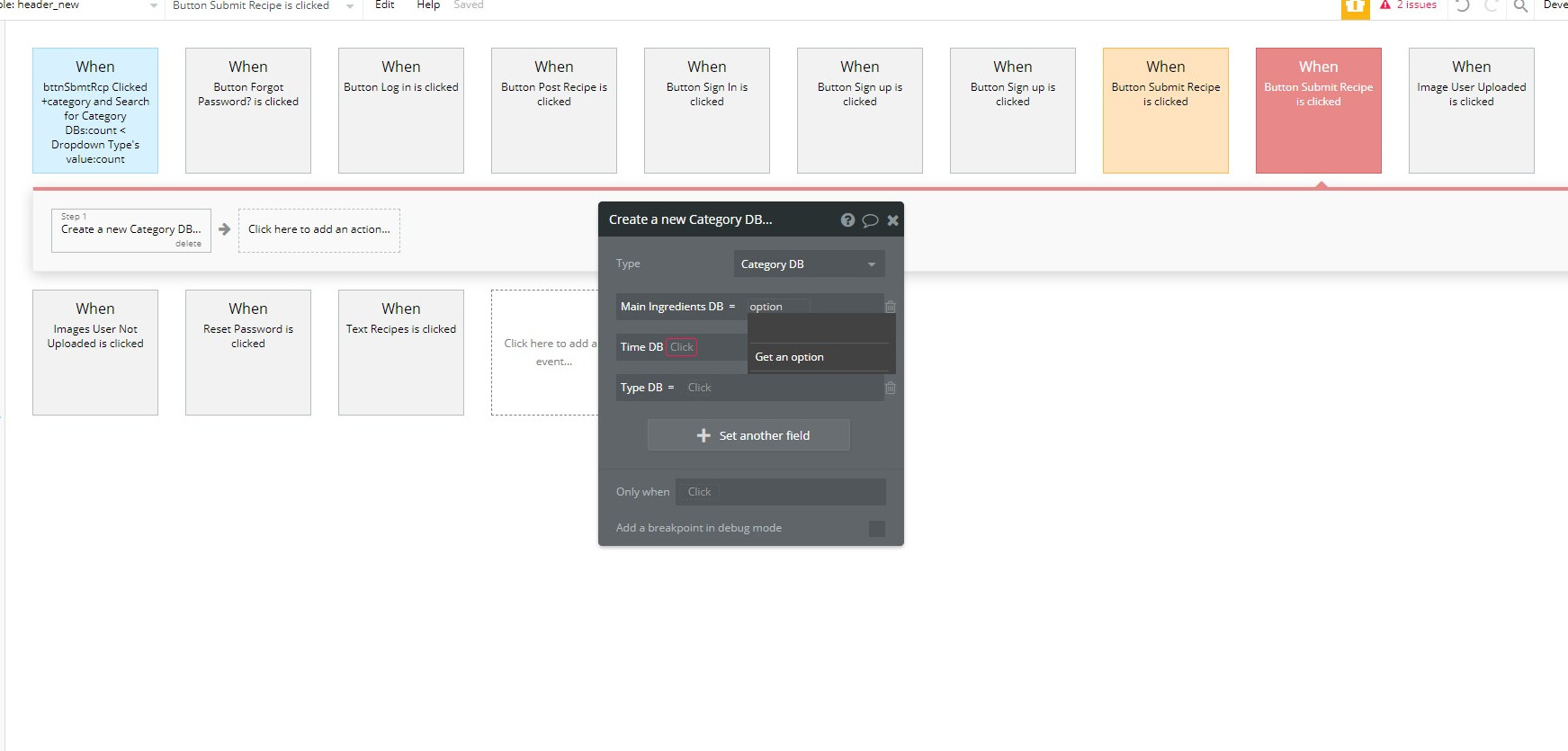

@adamhholmes - I can’t explain how much I appreciate your help, thank you! But, it’s still not working :unamused:
I’m trying Option 1 because I don’t have a paid plan (yet), so Option 2 I can’t embrace, and Option 3 pretty much calls for the same action as Option 1 - but with the added use of a plug in. Either way, I’’ have to “create a new thing” action to run each new tag - so, I tried #1 and it’s still not working

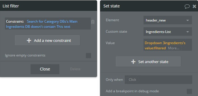

It is skipping over the second tag being entered into the dropdown :woman_shrugging: … crazy… No idea how something so theoretically simple should be so complicated.
would be grateful for other ideas or wo
I think you need to get rid of the filter on the field value (I don’t see the logic of applying a filter there) - I’m pretty sure that’s why it’s not working. Actually, looking at your database pic it looks like the entry has been created, it just hasn’t added any data to the Main Ingredient DB field, as you’ve filtered it to return an empty result.
You just want to set the Main Ingredient DB value to dropdown's value; item# 2, but only run the action that when an entry doesn’t already exist with that same value.
So add an ‘only when’ condition to the action: do a search for Category DBs with a constraint to match the Main Ingredient DB value to the value of the input’s item#2, and only run the action when the ‘count’ of those returned results is 0.
That should work fine (it works perfectly in a quick test app I made with the same setup).
