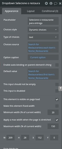

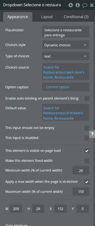

I have a simple dropdown in my application, everything was normal, but today some users reported that when they selected a dropdown option, it returned to the default option, I checked all my workflows and conditionals and nothing is doing something like that, I also followed in step in debug mode and nothing registered, simply the value returns to the default value, does anyone know anything?
@contato4 What are the criteria for the choices sources and default value? are there any reset relevant inputs actions?
Do you have any workflow running when this dropdown changes?

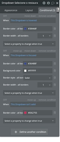

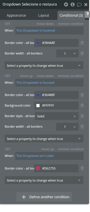

From the screenshots you’ve sent everything looks fine. The error should be in your workflow. Which workflow do you run after selecting an option from the dropdown?
If you have no workflow running for your dropdown then try to click on « this input should not be empty » and test again »
