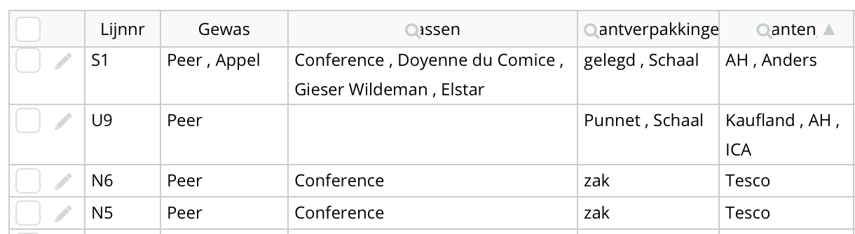

I have made a Client thing including their varieties
I have made a Line thing including their clients, packages and varieties
I have made a Package thing including clients

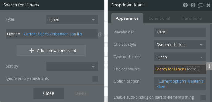

I have made a User thing including a field that contains 1 specific line number
So when a user(=line) is logged in I know the current user is line xx (in the screenshot is is set to line (Lijnnr) “S1”)
Now I want to have a:
*dropdown 1: client that only shows the clients that are connected to the current user line number
- dropdown 2: Variety that only shows the variety of current user line AND constrained with dropdown 1 value selected client
- dropdown 3: Package type that only shows the package of current user line AND constrained with dropdown 1 valuer selected client AND constrained with dropdown 2 value selected client.

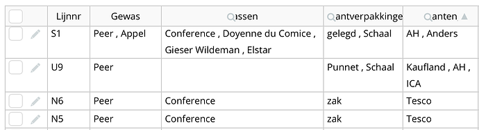

I was thinking that when I use the “Line thing” I should be able to do the job as it contains all values:
But before I can start with extra constrains I have this:
Resulting in only the first item of the multi value field rasnaam (variety):
results into all values of the multi value field klant(Client) as 1 selection row in the dropdown:
What is the right solution to do the job here?
