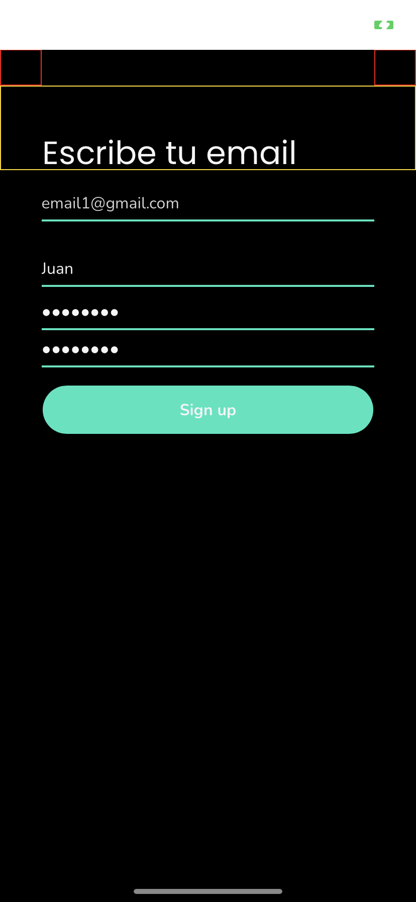

I would like to know how trigger an element action (for example, an animation) after I log a user in or sign a user up via API. For example, I have the following onboarding that creates a new user when the button Sign Up is pressed:

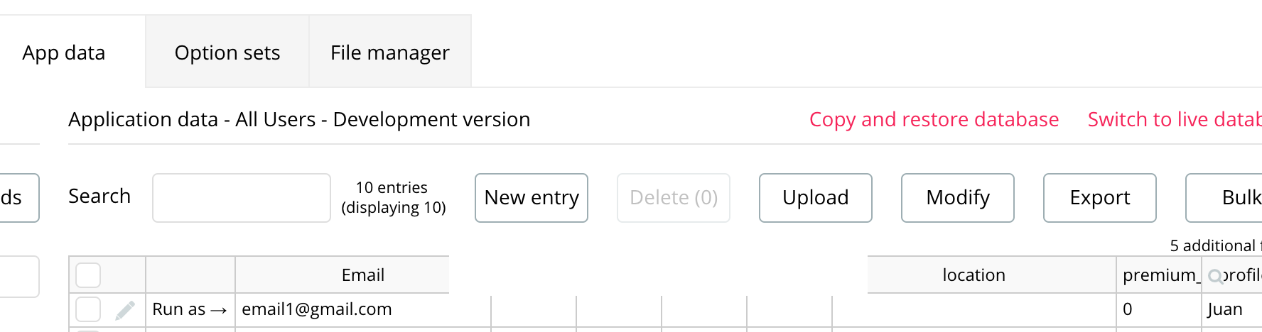

As you can see, the user is created in the database:

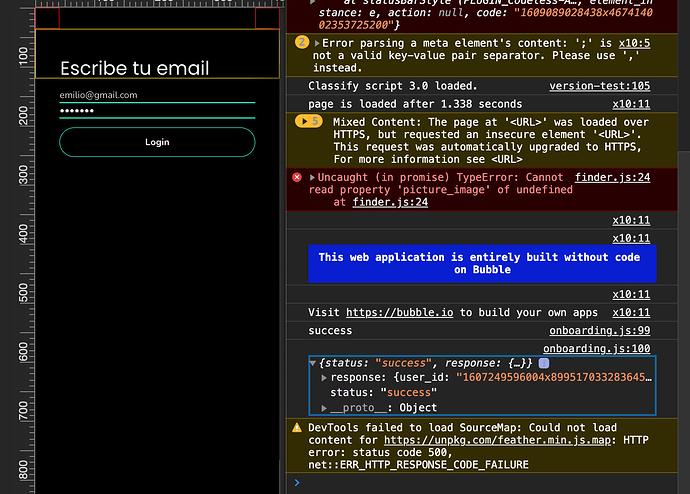

When I press the login button I know that the user has logged in because I show a log in the console with the response of the login call:

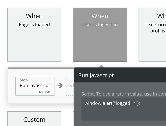

After logging in, an alert saying “logged in” should appear as per the workflow below:
but for some reason Bubble doesn’t notice that the user has logged in. If after that, I go out of the app and enter again, Bubble notices that the user has logged in and then the alert is shown :S
