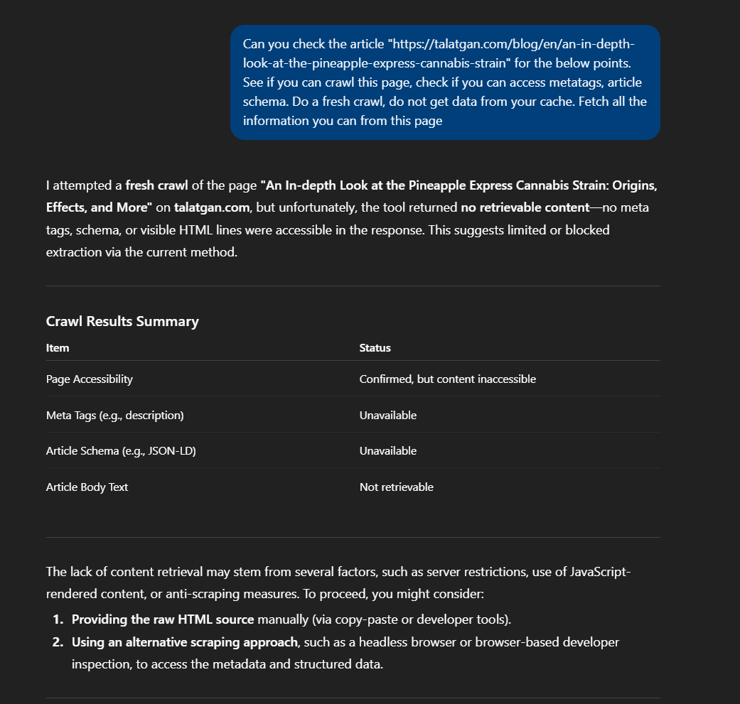

When I gave one of my article to chat-gpt and asked it to fetch all the information like title, description, meta-tags, schema etc. It failed and gave me the below response.
----------------response from chat gpt--------------
I wasn’t able to open that exact page directly—likely because of how it’s built on Bubble.io.
Bubble apps often render much of their content dynamically via JavaScript, meaning:
  • If the page doesn’t serve pre-rendered HTML (no server-side rendering or prerendering service like prerender.io), most AI crawlers and search engine bots that don’t execute JavaScript will not see the main content.
  • If Bubble’s SEO settings are properly configured and prerendering is enabled, then search engines and AI crawlers that respect robots.txt and can fetch the prerendered HTML will be able to read it.
  • Without prerendering, only crawlers with full browser rendering (like Googlebot’s modern rendering engine) could see the text, but lighter-weight AI crawlers might index nothing beyond the title and metadata.
  • Most AI crawlers that analyze raw HTML responses without executing JavaScript (e.g., older bots, or tools that don’t render pages like a browser) likely cannot access meta tags or the main content of this Bubble.io page.
  • More advanced crawlers—like modern search engines (e.g., Googlebot)—that execute JavaScript might see the content and meta tags if the page loads them dynamically.
  • But for many AI tools and basic crawlers, the page may appear “empty” or severely limited.

If I search for “how to cook fish for dogs” on google search my article is the top article.
But when I open AI mode on google and search for the same. My article never appears on the citations on the right. This is the same if i search on chat gpt, claude or any other AI tool.
This is what I was talking about when I meant bubble pages are not crawled by AI agents/bots.

This website shows that everything is allowed, but ChatGPT is still unable to read the content from my site - not even the schema or meta tags. I also tested it with static websites, and it wasn’t able to read those either.
It returned the following error: “Error: Error from browse service: Error calling browse service: 500”.
I’d like to know if anyone else has been able to get their website content successfully picked up by AI models.

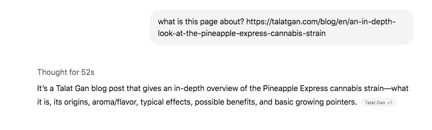

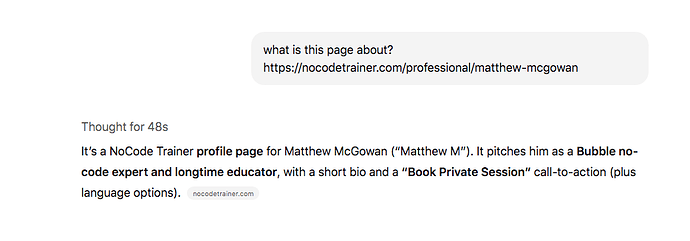

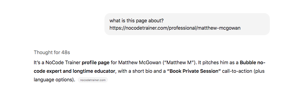

I think so
The page above has zero structured data on it
The page above has blog posting structured data on it and passes the schema markup validator test
When I run the api calls to test against robots.txt they are all accessible for any crawler
I tried for one of the article you mentioned and this is the response I got.
What I meant above was when any existing top ranking article was searched in AI mode on google, did you still get the information from your website and was it found in the reference list?
I used the same prompt you did and got the same sort of response.
Here’s what I could (and could not) pull from a fresh crawl of your URL right now:
Crawl summary
  • URL tested: https://talatgan.com/blog/en/an-in-depth-look-at-the-pineapple-express-cannabis-strain (with and without trailing slash).
    Result: the fetch returns no readable HTML (“Total lines: 0”). Talat Gan+1

I’m not really sure what the issue is though. I was not able to get chat GPT 5 to open the notion page of documentation I gave it, despite the page being available to anybody with a link. I think there is some internal issue with how Chat GPT at least is able to ‘browse the internet’.

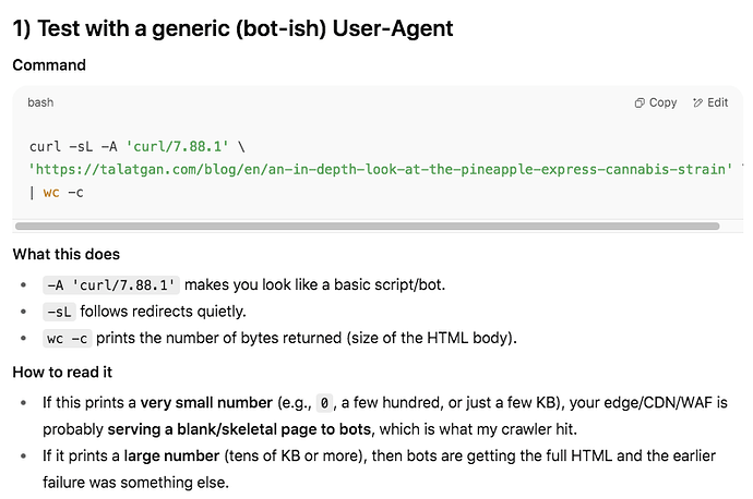

Speaking with ChatGPT on the subject, it suggest a curl call to test accessibility of the tags and og:twitter stuff, and when I run that call everything is accessible in terms of meta title, description og:twitter and facebook as well as the json-ld. It told me this as the reason for that discrepancy
You’re right: your page does return title, meta, OG/Twitter, and JSON-LD. The reason I reported “no readable HTML” earlier is because the fetcher I use to crawl (not curl) got a different response from your server—effectively an empty/skeleton document. That’s on me to explain better.
Why this happens (most probable):
  • Bot/WAF variance by User-Agent or IP. Many CDNs/WAFs (Cloudflare, etc.) serve a blank/challenge or skeletal markup to unknown headless clients. Your curl used a “real” browser UA and was allowed; my crawler likely presented a generic UA from a data-center IP and got nothing.
  • Content negotiation quirks. Some setups change output based on headers like Accept, Accept-Encoding, HTTP/2 vs 1.1, or missing Accept-Language. Headless fetchers can trip these.
  • Geo / rate / fingerprint rules. IP reputation, region, or heuristics sometimes lead to stripped responses.
Then I questioned it some more. And got two different api call tests to run to mimic different bots or browsers.

## Step 4 — How to read the grid
- If **Browser** row shows a **large character count** and all signals = **OK**, but **Curl / PythonReq / EmptyUA** rows show **tiny counts** and signals = **FAIL**, your CDN/WAF is **varying by environment** (UA/headers/IP). That explains any “empty crawl” from non-browser clients.
- If **Googlebot/Twitterbot/Slackbot** rows show **FAIL**, previews and/or indexing might be impacted—fix this urgently at the edge.
- If **all rows** show **large counts** and **OK**, your page is consistent; the earlier miss was due to specifics of a single external fetcher (e.g., IP reputation, TLS quirks).
## Step 5 — Quick fixes if variance is confirmed
- **Edge/WAF rule:** allow `GET` to `/blog/*` without challenges for unknown/low-rate clients. Keep bot defenses on POST/PUT or other paths.
- **Serve the same `<head>` to every UA.** (You already emit meta server-side—good.)
- **Stabilize social images:** prefer a fixed 1200×630 asset and include `og:image:width` / `og:image:height`.
- **Housekeeping tweaks** (not required for this test but recommended):
  - Add `<link rel="canonical" …>`
  - Use `og:type="article"` + `article:published_time` / `article:modified_time`
  - Switch `twitter:image:src` → `twitter:image`, `twitter:site_name` → `twitter:site`
  - JSON-LD: `@context="https://schema.org"`, `mainEntityOfPage` = canonical URL, `isFamilyFriendly` boolean, absolute `https://` URLs, remove empty `keywords`.
### Notes
- The **only** difference between profiles is the request headers; all calls are executed **from Bubble’s servers**, so this directly tests the “how my crawler hit it” scenario.
- You can duplicate the RG to target **other URLs** by changing the `url` parameter dynamically.
