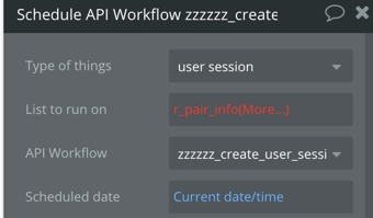

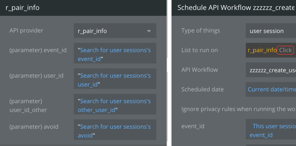

Do you know if “list to run on” in the Schedule an API on a list can accept a table not just a list from a single field (ie. place)? Also, do you know if “list to run on” needs to run a GET to the external API or can it be a POST response?
My external API r_pair_info is a table (red text). I’m POSTing data from Bubble->R and the response is a table.
that looks like this:
Your list will be the result of an action in your workflow I would think.
So do the post and then pick up the “result of step x” ?

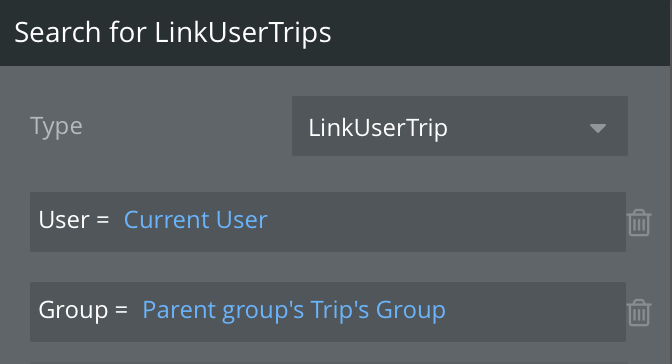

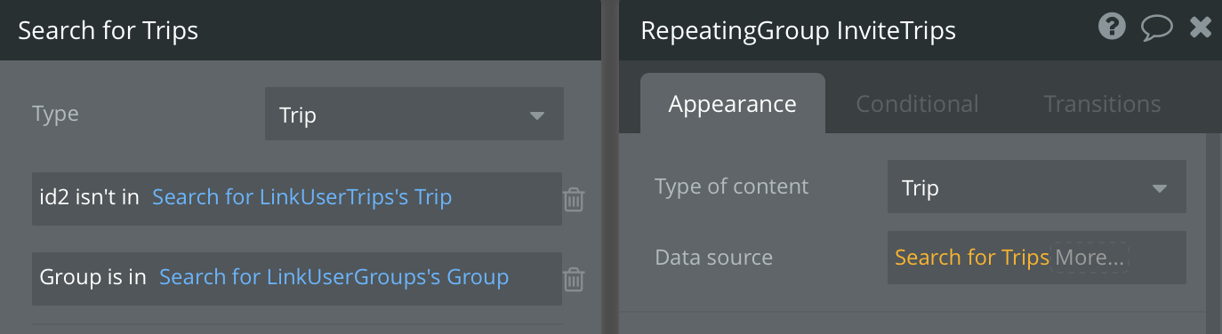

On the topic of creating multiple things; in my case it’s not possible to use a scheduled action or invoked externally via API. So I need to create the Things as the users starts to interact with them and simulate their existence before that through Conditional settings. See:
I also needed to show a list (Repeating Group) of Things not yet created(!). I managed to do that this way:
