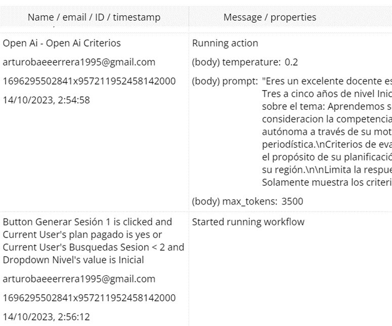

I started looking at the server logs and found this:
1)Before it starts to run it passes through a conditional that is this one that works fine.

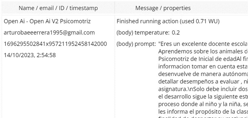

2)Afterwards it makes the first call to Chatgpt that initiates and finishes without problems

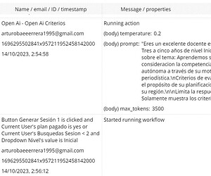

3)On the second call in this example, in between the initialization of the call and the end of it the conditional workflow starts all over again.(The conditional we saw on step 1).
Start of second call. OK.
I think this maybe the problem. It starts the workflow again.This already happened in step one.
Then it finishes the second call.
4)With the third call to chat gpt the same thing happens. In between it starts the conditional workflow again in between the beginning and the end of the call.
