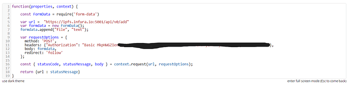

Do you know why I would get an Unauthorized response when using the code provide versus a successful response when using Postman with the same credentials?
have you added the Content-Type header?
I did and still getting the same error. I ended up just using the API connector for now since that’s basically what I’m trying to do. I’ll share what I did for others that want to post to IPFS.

I see you are using basic auth.
In the request you should use the auth option instead of the headers.
From the docs:
auth Basic authentication i.e. 'user:password' to compute an Authorization header.
That might be the source of the issue I’ll test it later and report back.
I tried using auth with user:password and still got an error project id required. I might return to this at a different date, but I will stick with the API Connector for now.
