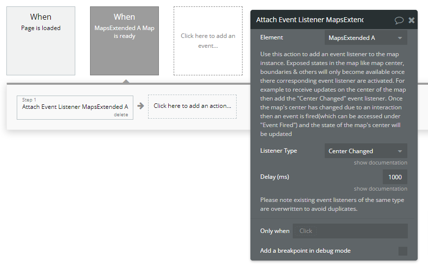

run.js:8 Action Attach Event Listener MapsExtended A - The plugin Google Maps Extended / action Attach Event Listener a Maps Extended threw the following error: TypeError: Cannot read properties of undefined (reading ‘_e3’)
getting the following error when using Event listener of MapsExtended plugin
workflow-
any ideas ?

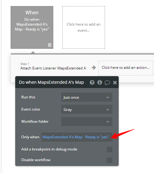

thanks :star_struck:@AliFarahat for helping me out
solution -

UP: Here’s what I found out. The described method only works when Debugmod is enabled. if you turn it off in the console, an error occurs and event tracking does not work.
@leskontgame… give it a shot now if you want.
