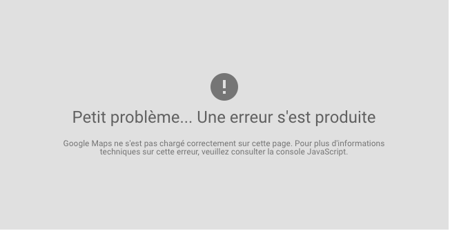

Hi @mazorshimon , it seems I’m passing through the same issues than you. I added the extended pluggin to display itinerary on a google map, and after all (I don’t really know why), the problem fixes itself. Now I have the same problem as you… in french :sweat_smile:
Capture d’écran 2020-09-28 à 17.33.44
Do you figured out what happened? How did you fix it?

Hi @AliFarahat, It’s a strange things going on here. When I preview the page, the previous message appears and the the google map extender’s map is not displayed . When I stay on this page, refreshing it again and again, most of the time it works, but sometimes it doesn’t (3 on 5). Without changing any parameters.
Could you help me with that?
Thanks again
