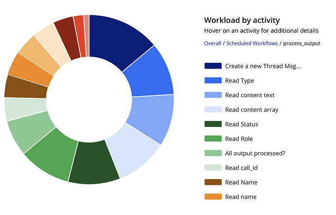

I have been investigating my workload unit usage because they are unacceptably high, up to point of being commercially unviable. Investigation showed that over 80% of my workload units are used by a very simple plugin that I use to read items from JSON structures. That sounds completely wrong to me. How can such a simple action, that should have been a core part of Bubble anyway, consume such excessive workload units?

Illustration is an example of one of my APIs, everyhing but create new thread msg is the plugin I am referring to. Most of my APIs look like this.

It are actually two plugins that are the source of over 80% of the workload units used. Both I use to keep the workflows efficient, readable and manageable:
  1. Read JSON and get value by key
  2. Store Temp Data (Result of Step X)
I am sending over raw JSON and then using the ’ Read JSON and get value by key’ plugin to get to individual items in the JSON structure.
If you inspect the plugin code, you will see that this plugin is Server side. So this is using WU.
You should check for a plugin that is client side instead (this will also be faster) if you are just using the plugin to show JSON data in frontend.
This is the same thing for the Store Temp Data. This is a server side plugin, so this consume WU.
What is the end goal of your processing and also what is the JSON (example) that you are processing?
You may need to consider cheaper solution to process your JSON…

Yes, I understand that these are server side actions. I am processing AI generated content and turning them into bubble.io things/db objects. Pretty much the same for the store temp data. That really is the only way to get some kind of structure in the workflows and keep them readable an manageable. It am considering moving most APIs of of bubble just for the reason of the excessive WU’s. This would be a major pain as we are talking over 250 APIs. :frowning:
Can you share your JSON? In most case, there’s a lot of way to process your data without using plugins…
Looks like you are using sequential actions, is that right? Each action costs 0.70 WU no matter what. I would recommend building your own plugin that allows 10/20/whatever keys to be processed in a single action, that way you only spend 0.70 WU to process everything.
