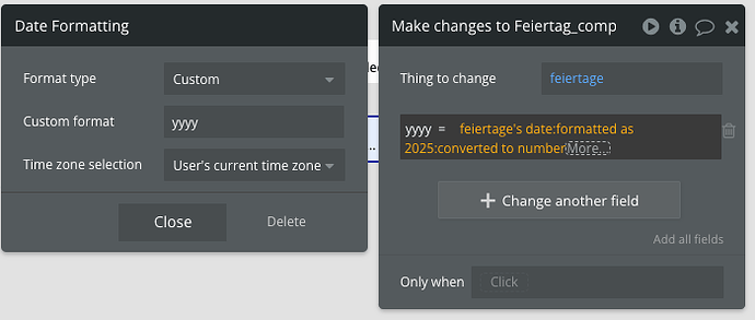

I have got a database where I have a field date (as date) and the year as number.
The fields with the dates are already prefilled with the specific dates.
I just created a workflow which extracts the year from the date-field and stores the year as a number into this field. I use this for the dropdown in order to group the dates.
Now it worked actually but on the 1st January of the year, the extracted year it the previous one. Can anybody tell my why?
See the date in the middle of the three records
And this is my workflow
Thank you for your support

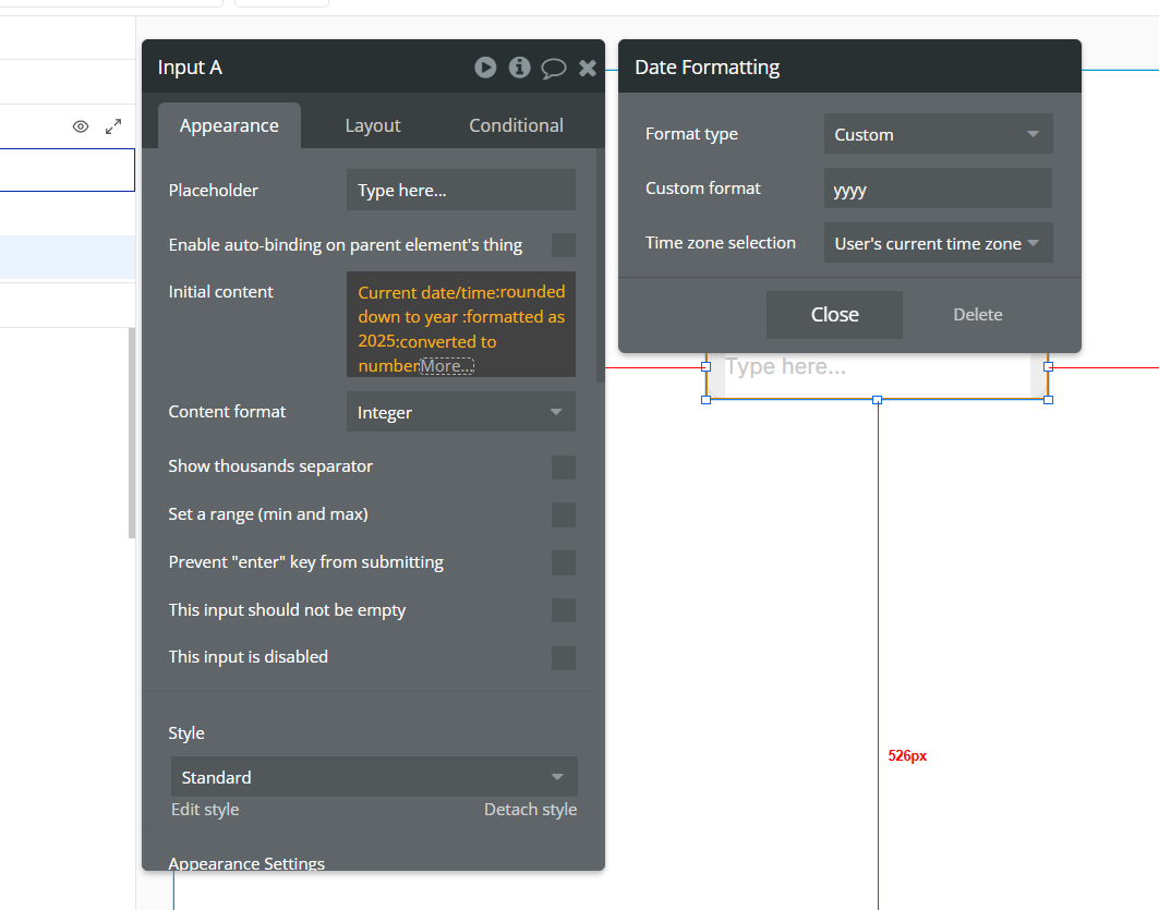

Hi @amit.chauhan Extract means just the year and rounded down will give me the whole datetime, isn’t it?
It’s probably a timezone issue…
What timezone are you using for the Extract Year expression?
I use the current timezone (I am based in Switzerland (GMT+2)
Monday, 31st March 2025, 13:23)
And is that the correct timezone to use?
Yes. The time and date would be right. And because I grap a datetime in the past (1st of Jan 2025) it is weird that I get 2024 as year.
It seems like an timezone issue but I do not get why when in the database stays 1/1/25 12 am and then the converted/extracted version minus 1 hour
Also see the different timestamps although it is always 12 am I get different hours on the converted column
