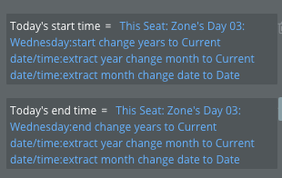

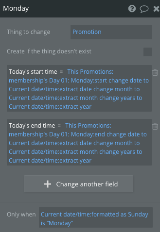

Every morning, an API script fetches the time_from and time_to from the relevant day:

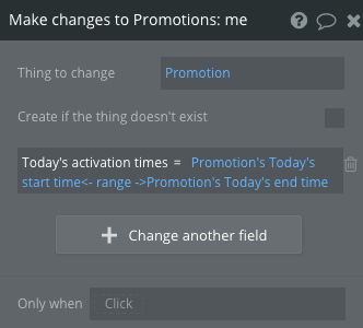

It then generates the date range to save today’s validity:

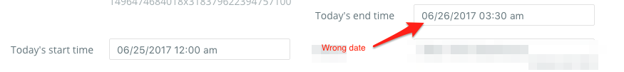

All good, right? Except, when the time is 4 am or earlier, it adds an extra day to the date:
So I try to correct this by subtracting 1 from the date, if extract:hour is equal to or less than 4. The problem is, it applies this no matter what time extract:hour returns, so that the date is wrong if the time is after 4 am.

I’m at a complete loss… even when I ignore the date altogether, and just pass a number as a parameter to the API, it ends up with the wrong date…!
I schedule the API, setting “5” as Date parameter:
I use the parameter to make changes in the date:
And still they end up different…
