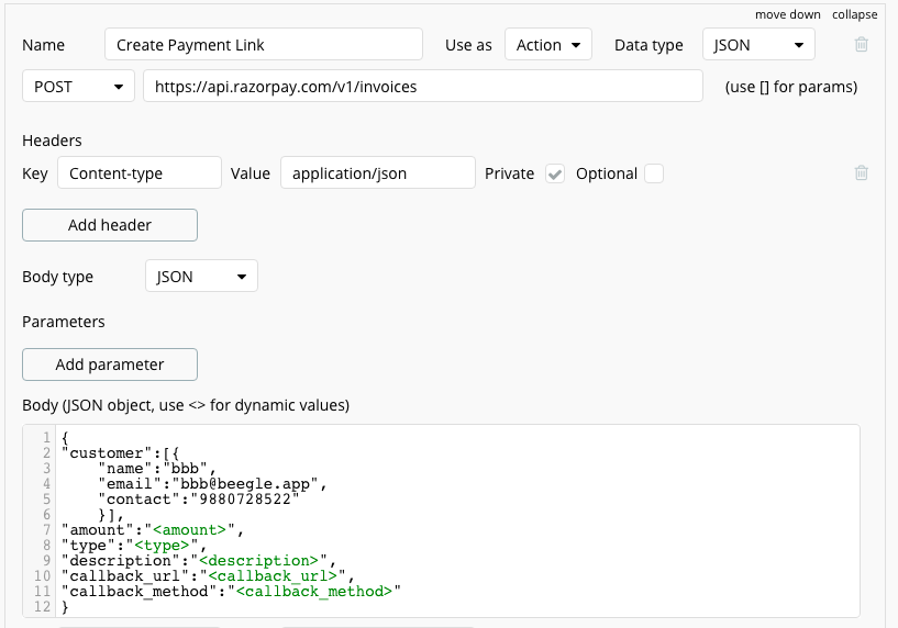

@ambroisedlg here are the screenshots.
Error message:
Overall API Setting:
Setting specific to this call:
@Jici as I had mentioned in my original post, the API call is working without the nested parameter and hence Content Type of errors are not the issue here. Yes, I have already set it up as application/json

@Jici So, your pointer about postman helped.
Actually there was nothing wrong in what I was trying as such.
Amazingly the spaces that I had given in before “name”, “email” etc. sub fields in the “customer” segment were not right. Either the number of spaces were not right, or it was expecting a tab there. Not sure.
Here’s the final thing that worked.
  "customer": {
    "name": "<name>",
    "email": "<email>",
    "contact": "<contact>"
  "type": "link",
  "amount": "<amount>",
  "currency": "INR",
  "description": "Beegle Services",
  "callback_url": "<callback_url>",
  "callback_method": "get"
It is same as one of my previously tried versions, except for the spaces in the nested field.
