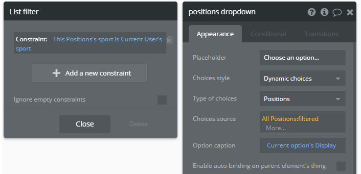

Hi - I’m creating a sports app for college student athletes. I have an option set which is a list of positions, each position has an attribute of a corresponding sport (sport is also an option set). How can I create a dropdown where it filters to only show positions with attributes that correspond to the current users sport. See example below
Position:
Catcher (attribute: baseball)
Pitcher (attribute: baseball)
Quarterback (attribute: football)
Wide Receiver (attribute: football)
I want to have a drop down that checks the users sport an only shows the positions that have the attirbute that matches users sport
Hi there, @patrick6… assuming that your sport attribute and the sport field on the User data type are both tied to your sport option set, this setup for the dropdown will do the trick…
Hope this helps.
Best…
Mike
Yes this solved my issue! Thanks!
