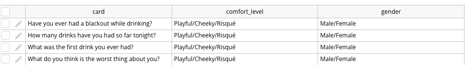

The Gender description is associated with each item. The data table has 3 fields:
  • Card
  • Comfort level
  • Gender
It is the Card field that is selected at random and displayed, I want the choice to be based on the Gender field. The next stage is to nest another filter on Comfort level too, again another user selection.

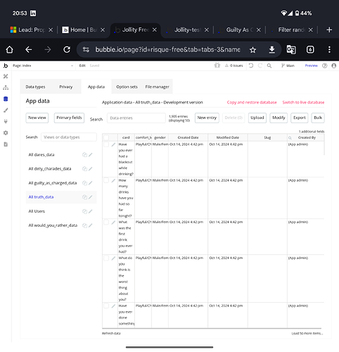

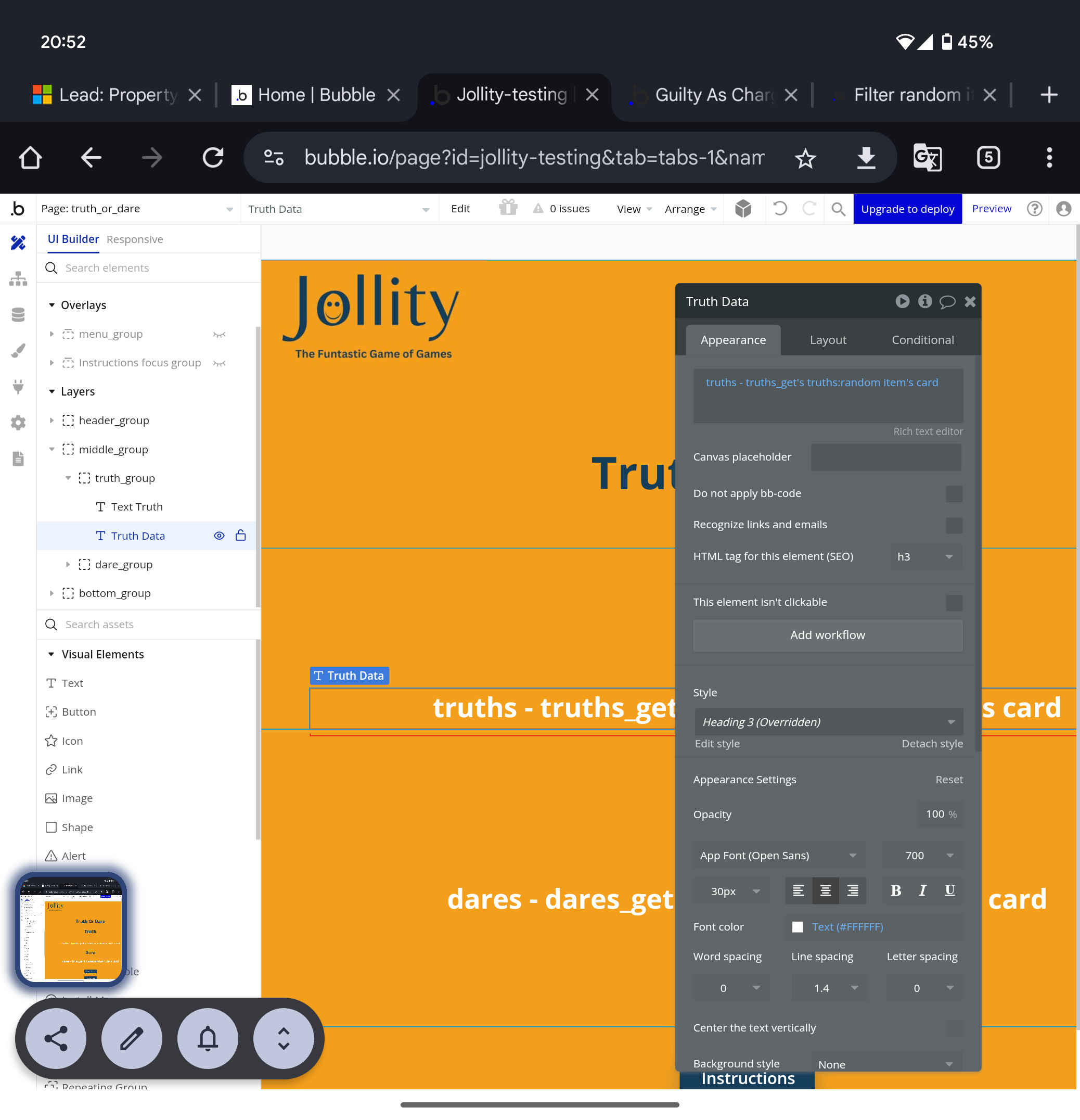

Thanks for the response. I have attempted to add the constraint but failed. Here are the screenshots of the app pages and data table.

Each truth data should have only one gender. After fixing this, you can filter your data here
gender = dropdown gender's value
Also you don’t need the refresh the page step for the draw the truth card button.
